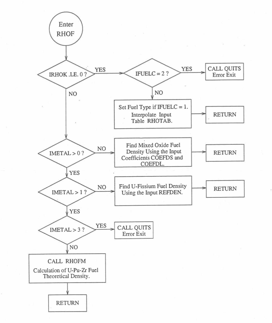

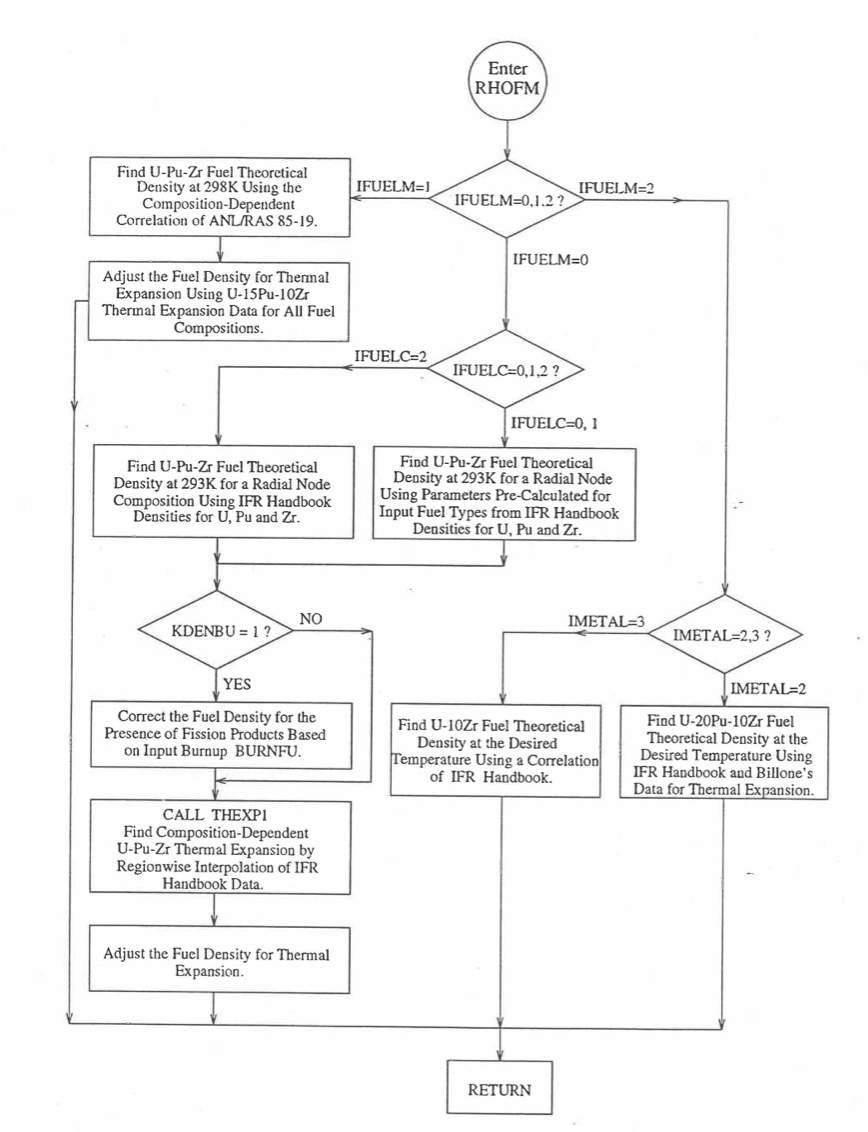

../../_images/image313.png
Figure 10.3.2 Flow Diagram of Function Subprogram RHOF for Fuel Theoretical Density.

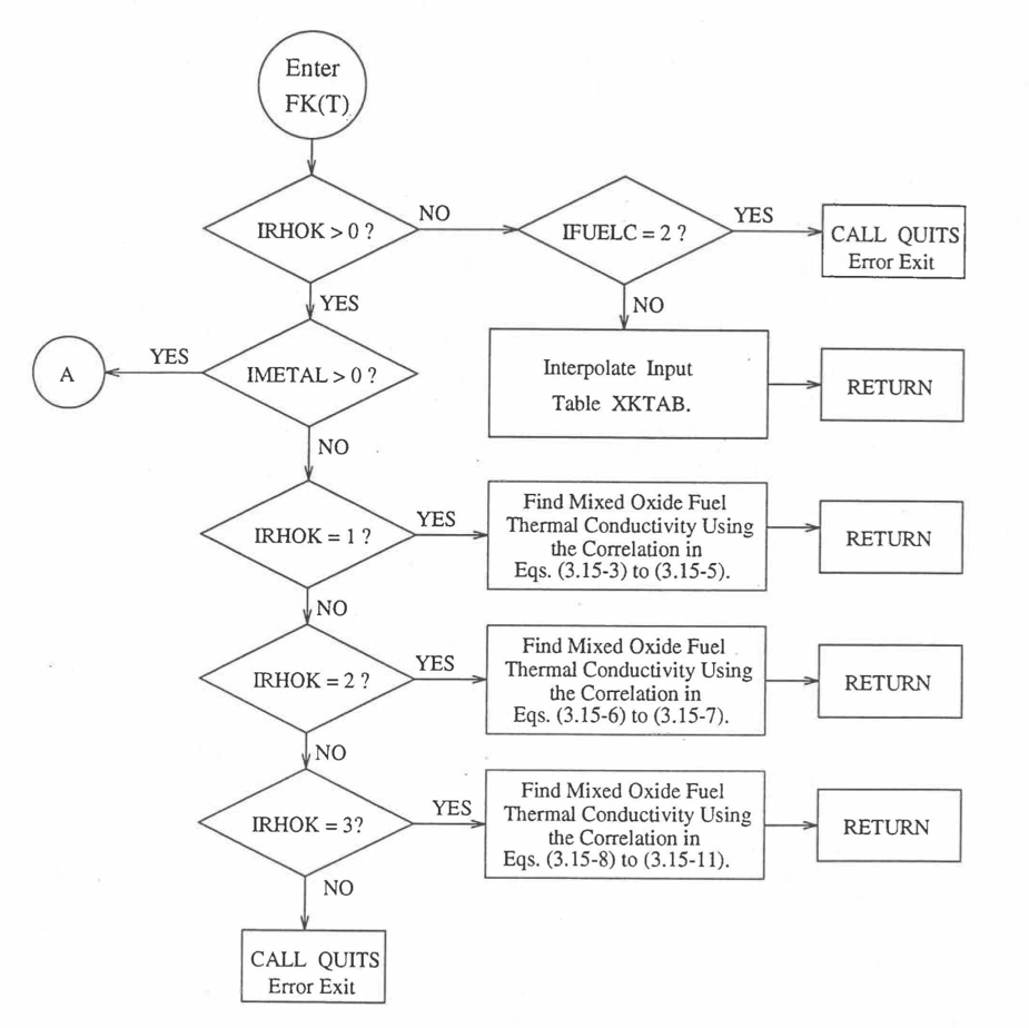

../../_images/image47.png
Figure 10.3.3 Flow Diagram of Function subprogram FK for Thermal Conductivity of a Single Fuel Radial Node.
../../_images/image55.png
Figure 10.3.4 Flow Diagram of Function subprogram FK for Thermal Conductivity of a Single Fuel Radial Node (Cont’d).

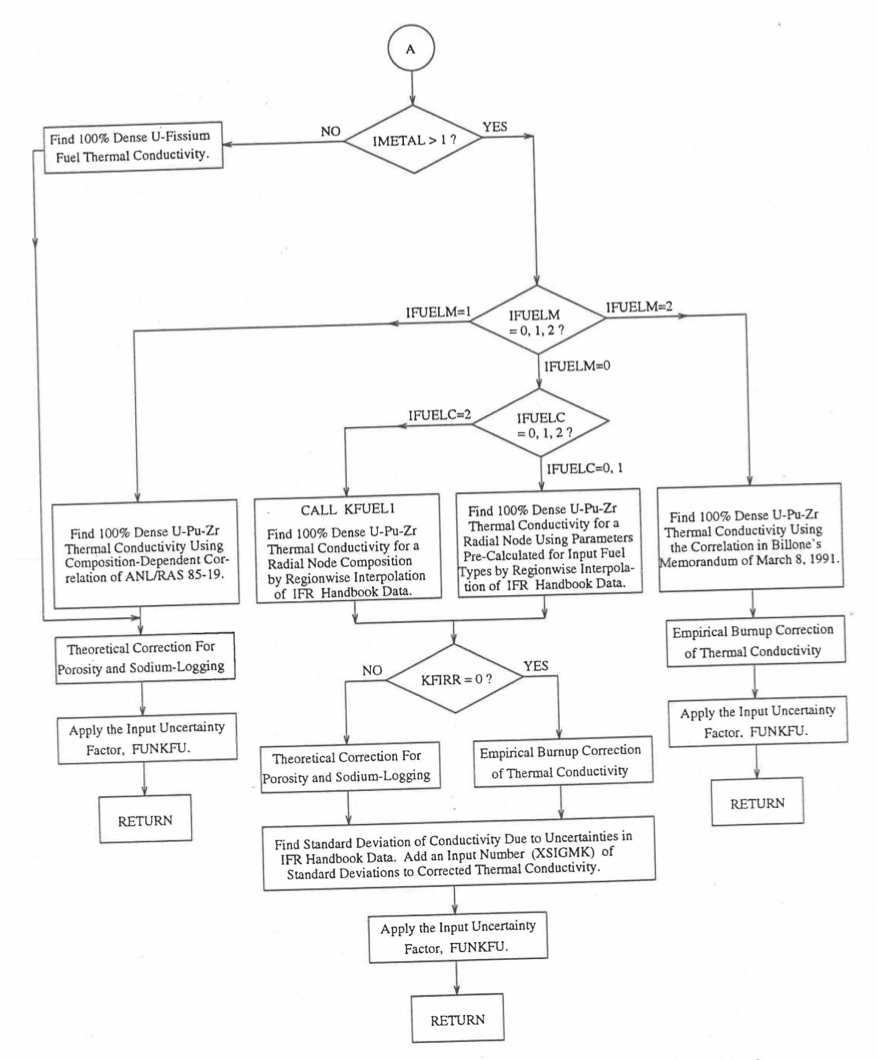

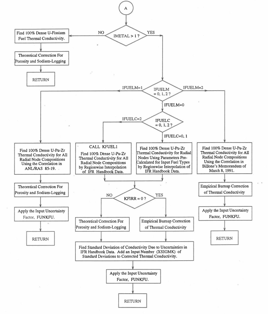

../../_images/image64.png
Figure 10.3.5 Flow Diagram of Subroutine KFUEL for Thermal Conductivity of All Fuel Radial Nodes in a Pin Axial Segment.

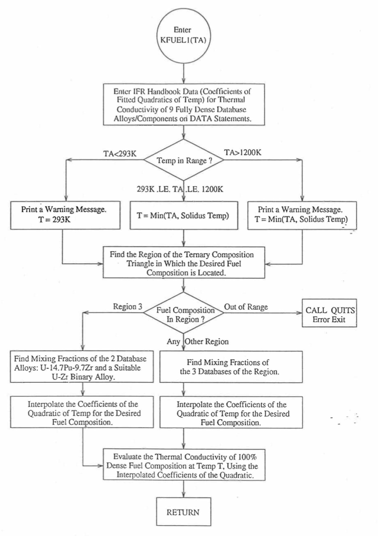

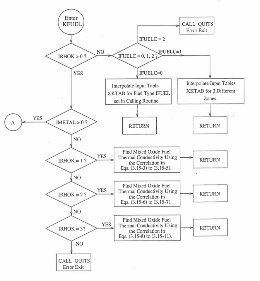

../../_images/image73.png
Figure 10.3.6 Flow Diagram of Subroutine KFUEL for Thermal Conductivity of All Fuel Radial Nodes in a Pin Axial Segment (Cont’d).

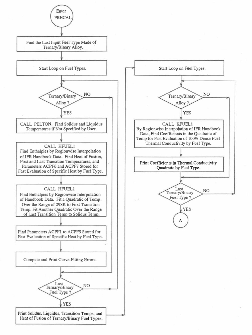

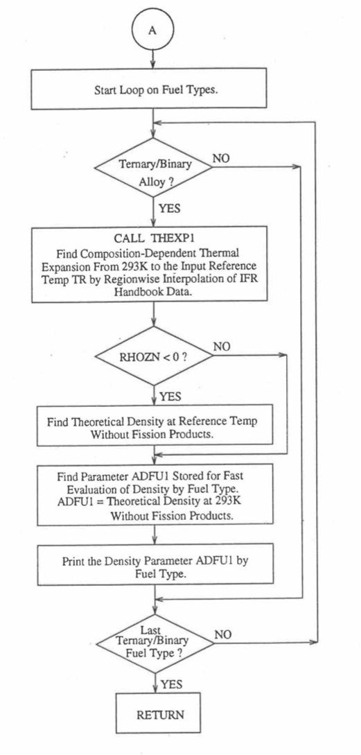

Figure 10.3.7 shows the flow diagram of a subroutine PRECAL that is called by the input driver routine INPDRV (see flow diagram of Figure 2.2.2) to pre-calculate, using the method of regionwise interpolation, certain parameters (described below) stored for fast evaluation of U-Pu-Zr alloy fuel thermal properties by fuel type. Fuel thermal properties by fuel type can be used only in case of a single radial fuel zone (IFUELC=0), or multiple (i.e., up to 3) radial fuel zones (IFUELC=1), but not when each fuel radial mesh interval is a unique zone of a different alloy composition (IFUELC=2). In the latter case, fuel thermal properties are evaluated directly using the fuel compositions of the mesh intervals. The pre-calculated parameters by fuel type evaluated by the subroutine PRECAL are not used when IFUELC=2.
../../_images/image83.png
Figure 10.3.7 Flow Diagram of Subroutine PRECA1 to Pre-Calculate Parameters Stored for Fast Evaluation of U-Pu-Zr Specific Heat, Theoretical Density and Thermal Conductivity by Fuel Type.
../../_images/image93.png
Figure 10.3.8 Flow Diagram of Subroutine PRECA1 to Pre-Calculate Parameters Stored for Fast Evaluation of U-Pu-Zr Specific Heat, Theoretical Density and Thermal Conductivity by Fuel Type (Cont’d).

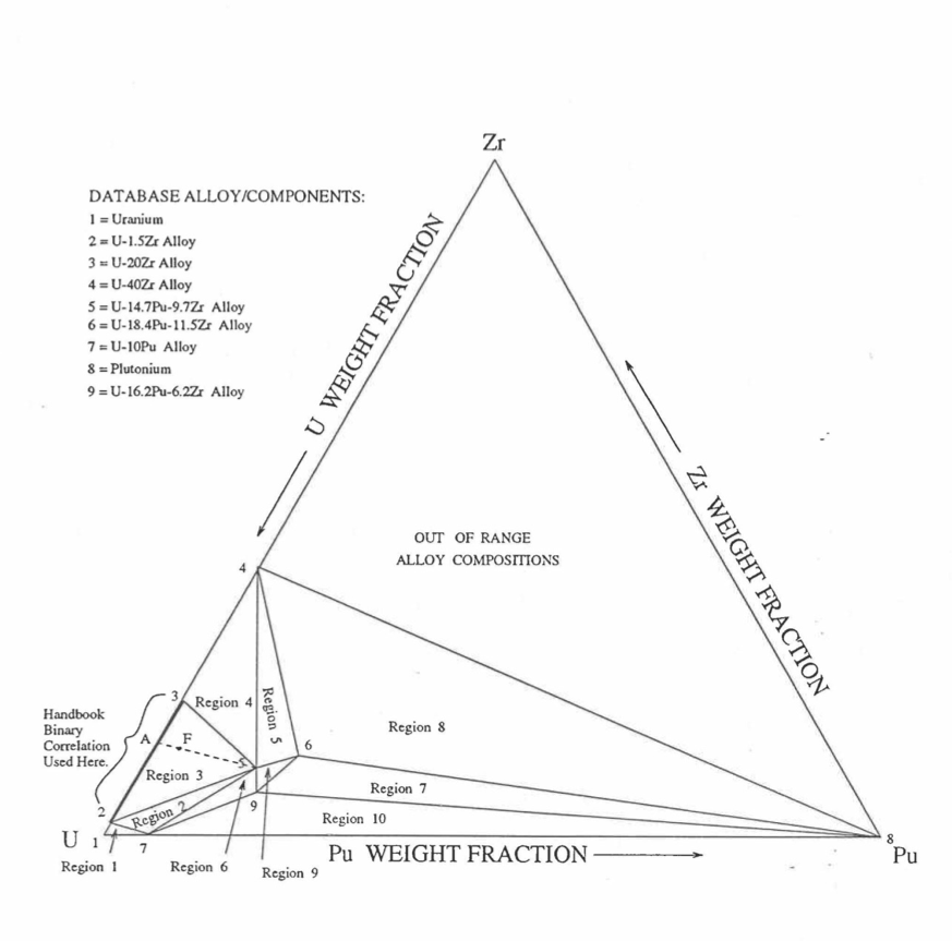

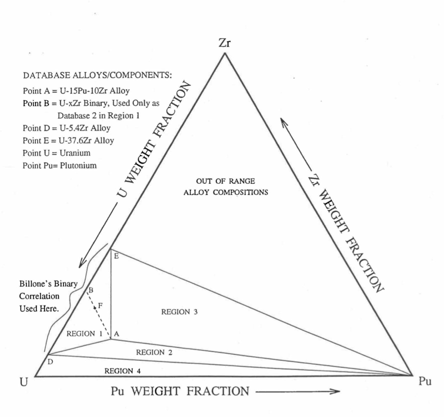

Figure 10.3.9 shows the U-Pu-Zr ternary system composition triangle. To perform design and safety calculations for the Mark-V fuel and other metallic alloy fuels important in the IFR program, including the different fuel compositions across the pin radius caused by migration of fuel constituents during reactor operation, it is sufficient to be able to evaluate enthalpy of alloy compositions (represented by points) located in a small region, equal in area to about one-third of the whole composition triangle, in the U corner of the triangle. The present method models and evaluates the enthalpy of all alloy compositions located in the triangular region UEPu of Figure 10.3.9.
The enthalpy of a molten alloy (at and above its liquidus temperature) as a function of composition is evaluated in the present method by assuming the molten alloy to be an ideal solution of the 3 liquid components U, Pu and Zr. The enthalpy evaluation approach for the molten alloy is changed from that for the solid alloy because (1) the IFR Metallic Fuels Handbook uses this 3-component ideal solution assumption for evaluating enthalpy of molten U-10Zr, and U-15Pu-10Zr, and recommends this assumption for other alloy compositions, and (2) the solid-state phase structure is lost after melting, i.e., the liquid obtained after melting is the same irrespective of the solid phase which melted; the alternate approach of arriving at the enthalpy at liquidus by adding the heat of fusion and the sensible heat (required for raising temperature form solidus to liquidus) to the enthalpy at solidus contains uncertainties which can be avoided by using the 3-liquid ideal solution assumption. Between the solidus and liquidus temperatures, the enthalpy of the alloy is linearly interpolated as recommended in the Metallic Fuels Handbook. The solidus and liquidus temperatures required in the present method may be either obtained from experimental measurements for the desired alloy, if available, or calculated using a subroutine developed by Pelton [10-13] and incorporated into the SAS4A/SASSYS-1 codes.
../../_images/image104.png
Figure 10.3.9 Diagram Showing Enthalpy Interpolation Regions for Solid U-Pu-Zr Ternary Alloy.
Base on the enthalpy data available in the IFR Handbook, the present method divides the triangular region UEPu, i.e., the region representing all those alloy compositions whose enthalpy in the solid state can be evaluated by the present method, into four regions as shown in Figure 10.3.9. There are data in the Handbook for solid U, Pu, U-15Pu-10Zr (represented by point A in Figure 10.3.9), and six U-Zr binary alloys with Zr content ranging form 5.4 wt % (point D) to 75.7 wt %. Because the IFR program deals with fuels having a limited amount of Zr, the highest Zr content U-Zr binary alloy data used in the method is that of U-37.6 wt % Zr (point E). In region 1 given by triangle ADE of Figure 10.3.9, the enthalpy of a solid U-Pu-Zr alloy of a desired composition represented by point F is obtained by mixing or linearly interpolating between the database alloys A (i.e., U-15Pu-10Zr) and B (i.e., the U-Zr binary defined by the point of intersection of line AF). The Zr content of binary alloy B is given in Section D, and the enthalpy of this binary alloy is found form a correlation by Billone [10-12] of all the enthalpy data in the Handbook for U-Zr alloys between points D and E. The coefficients of this correlation are composition-dependent. By comparison with data in the Handbook, this U-Zr enthalpy correlation has been found to be accurate.
The enthalpy of a solid U-Pu-Zr alloy of a desired composition represented by a point inside region 2 (given by triangle ADPu of Figure 10.3.9 is obtained by mixing the 3 database alloys A, D (i.e., U-5.4Zr) and Pu metal. The enthalpy of a solid U-Pu-Zr alloy of a desired composition represented by a point inside region 3 (given by triangle AEPu) is obtained by mixing the 3 database alloys A, E (i.e., U-37.6Zr) and Pu as shown in Table 10.3.1. Regions 1, 2 and 3 are all in the vicinity of the important ternary fuel U-15Pu-10Zr, and in the present method the enthalpy data for this fuel has a proportional influence on the interpolated enthalpy for any desired alloy composition in these three regions. The enthalpy of a solid U-Pu-Zr alloy of a desired composition represented by a point inside region 4 (given by triangle UDPu) is obtained by mixing the database alloy D, and U and Pu metals. The enthalpy of U metal used in the present method is obtained from data and correlation given in the Handbook because an extrapolation of the U-Zr binary alloy enthalpy correlation does not produce an accurate U metal enthalpy. The enthalpies of the database alloys used in the interpolation are given in Section C. The proportions or weight fractions of the 3 database alloys in mixing are given in Section D.
Between the first and the last solid-state phase transition temperatures, 873 K and 923 K, the specific heat of database alloy A (i.e., U-15Pu-10Zr) is much higher than the specific heat above and below this temperature range. These transition temperatures, denoted by \(T_{\alpha}\) and \(T_{\gamma}\), are required for the other database alloys and the desired U-Pu-Zr alloy in order to accurately account for the specific heat variation over this temperature range. In the present method, these transition temperatures for the U-Zr binary alloys used as database, and for all U-Pu-Zr ternary alloy compositions in regions 1, 2 and 3 are assumed to be equal to those of database alloy A because of lack of composition-dependent correlations for the transition temperatures. Such an assumption was suggested by Billone [10-12] for U-Pu-Zr alloys in the vicinity of U-15Pu-10Zr, and for U-Zr binary alloys used in mixing calculations. The choice of \(T_{\alpha}\) and \(T_{\gamma}\) for Pu metal is immaterial because its enthalpy data, after the simplification suggested by Billone [10-12] and described in Section C, does not have any temperature range of abruptly high specific heat. In region 4 of Figure 10.3.9, the average specific heat of U metal between its first and last transition temperatures is abruptly high, and therefore, \(T_{\alpha}\) is interpolated between the value of \(T_{\alpha}\) (942 K) for U metal [10-8] and the assumed value for other databases (873 K); and \(T_{\gamma}\) is interpolated between the value of \(T_{\gamma}\) (1049 K) for U metal [10-8] and the assumed value for other databases (923 K). These transition temperatures are summarized in Table 10.3.1.
Section C describes the enthalpy correlations for the basic alloys and their comparison with the data in the Handbook. Section D describes the equations used for interpolating between the database alloys. Section E summarizes the variation of fuel enthalpy with composition computed using the subroutine HFUEL1 based on this method.

a These regions are shown on the U-Pu-Zr ternary composition triangle in Figure 10.3.9.
b \(T_{\alpha}\) and \(T_{\gamma}\) denote the first and the last solid-state phase transition temperatures of the alloy. \(T_{\alpha}\) and \(T_{\gamma}\) of alloy compositions in the vicinity of U-15Pu-10Zr are assumed to be equal to those of U-15Pu-10Zr, i.e., 873 K and 923 K, as suggested by Billone [10-12].
c The weight fraction x of Zr is selected such that the point representing U-xZr binary lies on the line joining the points representing the desired alloy composition and U-15Pu-10Zr database alloy on the ternary composition triangle shown in Figure 10.3.9.
d Interpolated between 942 K (the value for U metal) and 873 K (the assumed value for other databases, see footnote b).
e Interpolated between 1049 K (the value for U metal) and 923 K (the assumed value for other databases, see footnote b).

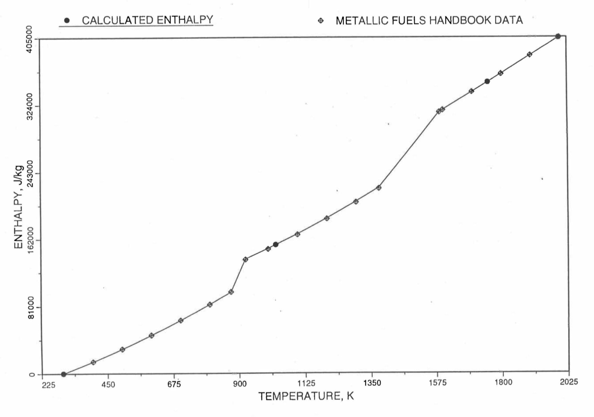

Figure 10.3.10 to Figure 10.3.16 show the temperature dependence of the enthalpy of all the basic alloys used in the present method. The difference in behavior of a database alloy when mixed to produce a desired alloy composition, e.g., U-20Pu-20Zr, as compared to its behavior in isolation is also clarified by these figures. For this purpose, the comparison of enthalpy of the basic alloy in isolation, evaluated from the correlations used in the present method, with the data in the Metallic Fuels Handbook [10-8] is also shown. These plots cover the entire temperature range from 298 K (zero enthalpy reference temperature) to 2000 K, a temperature well beyond the liquidus. In the following sections, the enthalpy correlations of the database alloys for use in solid and liquid phases are separately described.

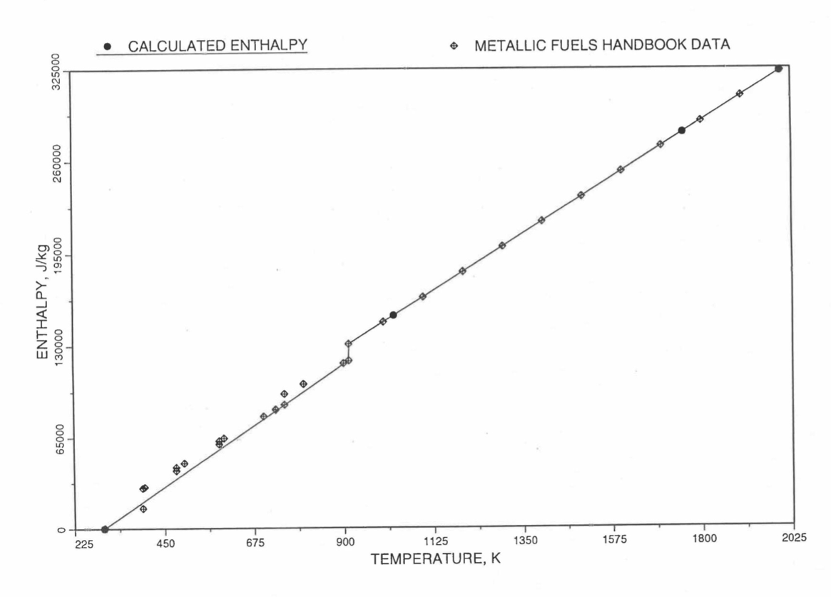

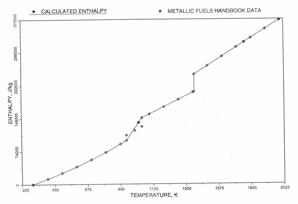

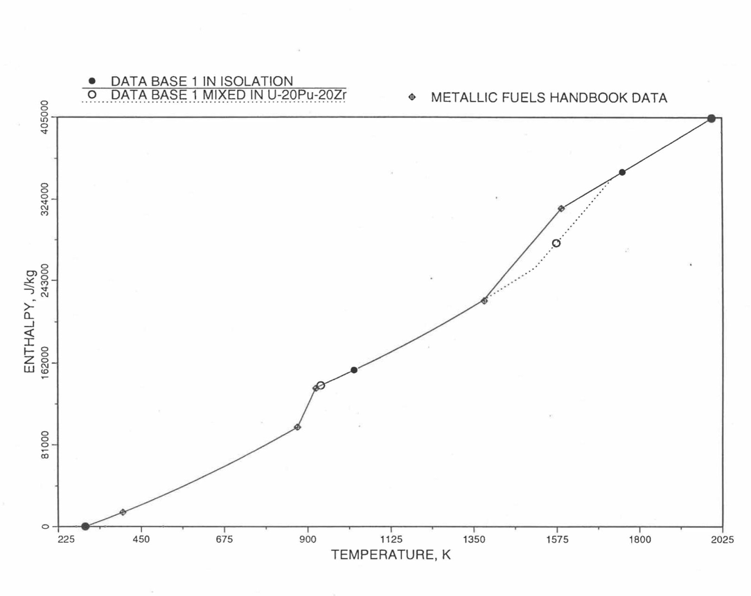

../../_images/image114.png
Figure 10.3.10 Enthalpy of U-15Pu-10Zr Obtained from Eq. (10.3-2) to Eq. (10.3-5) That is Used as Database 1 in Regions 1, 2 and 3; and its Comparison with Metallic Fuels Handbook Data.

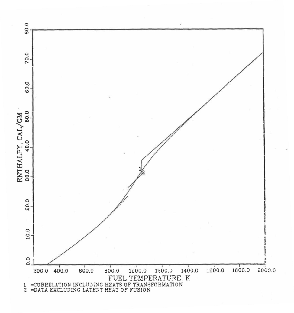

../../_images/image123.png
Figure 10.3.11 Enthalpy of U Metal Obtained From Eq. (10.3-2) and Eq. (10.3-6) That is used as Database 1 in Region 4; and its Comparison With Metallic Fuels handbook Data.
../../_images/image132.png
Figure 10.3.12 Enthalpy of U-5.4Zr Obtained From Eq. (10.3-2), Eq. (10.3-4) and Eq. (10.3-7) That is Used as Database 2 in Regions 1, 2 and 4; and its Comparison With Metallic Fuels Handbook Data.
../../_images/image142.png
Figure 10.3.13 Enthalpy of U-10Zr Obtained from Eq. (10.3-2), Eq. (10.3-4) and Eq. (10.3-7) That is Used as Database 2 in Regions 1, 2 and 4; and its Comparison With Metallic Fuels Handbook Data.
../../_images/image153.png
Figure 10.3.14 Enthalpy of U-21.1Zr Obtained From Eq. (10.3-2), Eq. (10.3-4) and Eq. (10.3-7) That is Used as Database 2 in Region 1; and its Comparison With Metallic Fuels Handbook Data.
../../_images/image164.png
Figure 10.3.15 Enthalpy of U-37.6Zr Obtained From Eq. (10.3-2), Eq. (10.3-4) and Eq. (10.3-7) That is Used as Database 2 in Regions 1 and 3; and its Comparison With Metallic Fuels Handbook Data.

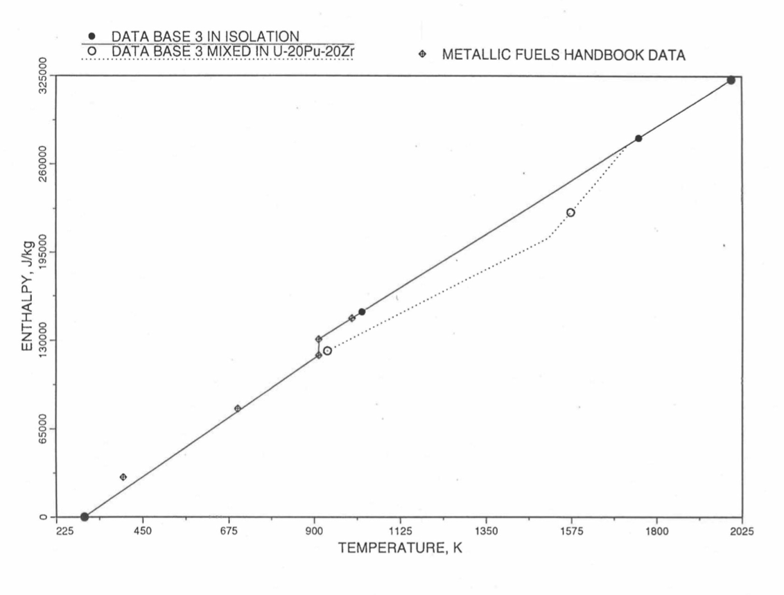

../../_images/image174.png
Figure 10.3.16 Enthalpy of Pu Metal Obtained From Eq. (10.3-3) and Eq. (10.3-8) That is Used as Database 3 in Regions 2, 3 and 4; and its Comparison With Metallic Fuels Handbook Data.

  1. Database 1 Used in Solid Phase
As described in Section B, the ternary fuel U-15Pu-10Zr is used as database 1 in regions 1, 2 and 3 of Figure 10.3.9; and the U metal is used as database 1 in region 4. The enthalpy data and correlation for U-15Pu-10Zr presented in the Metallic Fuels Handbook [10-8] and in the memorandum by Billone [10-12] can be written as
(10.3-5)\[\begin{split}H_{\text{a}} \left( T \right) = \begin{cases} \begin{aligned} & 19.34 \left( T - 298 \right) + 0.0133 \left( T^{2} - 298^{2} \right) & T \leq 873 \text{ K} && \text{(10.3‑5a)} \\ & H_{\text{a}} \left( 873 \right) + 162 \left( T - 873 \right) & 873 < T \leq 923 \text{ K} && \text{(10.3‑5b)} \\ & H_{\text{a}} \left( 923 \right) + 8.752 \left( T - 923 \right) + 0.01304 \left( T^{2} - 923^{2} \right) & 923 < T \leq 1379 \text{ K} && \text{(10.3‑5c)} \\ & H_{\text{a}} \left( 1379 \right) + 89.95 \left( T - 1379 \right) & 1379 < T \leq 1588 \text{ K} && \text{(10.3‑5d)} \\ & H_{\text{a}} \left( 1588 \right) + 44.4 \left( T - 1588 \right) & T > 1588 \text{ K} && \text{(10.3‑5e)} \end{aligned} \end{cases}\end{split}\]
where
\(H_{\text{a}}\) = enthalpy of U-15Pu-10Zr alloy, J/mol
\(T\) = temperature of the alloy, K
Here 1379 K and 1588 K are the solidus and liquidus temperatures of this alloy. In the present method, Eq. (10.3-5) and Eq. (10.3-5) are never required. Eq. (10.3-5) covers the temperature range containing solid-state phase transitions. When mixed to form a desired U-Pu-Zr alloy composition, Eq. (10.3-5) for the enthalpy in the temperature range above the solid-state phase transitions is extended up to the solidus temperature of the desired alloy. This difference in behavior of U-15Pu-10Zr when mixed to produce a desired alloy composition, e.g., U-20Pu-20Zr, as compared to its behavior in isolation is shown in Figure 10.3.10.
The enthalpy data and correlation for U metal (used as database 1 in region 4) presented in the Metallic Fuels Handbook [10-8] can be written as
(10.3-6)\[\begin{split}H_{\text{u}} \left( T \right) = \begin{cases} \begin{aligned} & 26.92 \left( T - 298 \right) - 1.251 \times 10^{-3} \left( T^{2} - 298^{2} \right) + \\ & 8.852 \times 10^{-6} \left( T^{3} - 298^{3} \right) - 7.7 \times 10^{4} \left\lbrack \frac{1}{298} - \frac{1}{T} \right\rbrack & T \leq 942 \text{ K} && \text{(10.3‑6a)} \\ & H_{\text{u}} \left( 942 \right) + 113.467 \left( T - 942 \right) , & 942 < T \leq 1049 \text{ K} && \text{(10.3‑6b)} \\ & H_{\text{u}} \left( 1049 \right) + 38.284 \left( T - 1049 \right) , & 1049 < T \leq 1408 \text{ K} && \text{(10.3‑6c)} \\ & H_{\text{u}} \left( 1408 \right) + 9142 + 48.66 \left( T - 1408 \right) , & T > 1408 \text{ K} && \text{(10.3‑6d)} \end{aligned} \end{cases}\end{split}\]
where
\(H_{\text{u}} \left( T \right)\) = enthalpy (J/mol) of U metal at temperature T(K).
Here 942 K and 1049 K are the first and the last solid-state phase transition temperatures of U metal, and 1408 K is the melting point. The average specific heat [10-8] over the solid-state phase transition range is 113.467 J/mol-K as used in Eq. (10.3-6). In the present method, Eq. (10.3-6) is never required. When mixed to form a desired U-Pu-Zr alloy composition, Eq. (10.3-6) for the enthalpy in the temperature range above the solid-state phase transitions is extended up to the solidus temperature of the desired alloy. This difference in behavior of U metal when mixed to produce a desired alloy composition, e.g., U-20Pu-2Zr, as compared to its behavior in isolation is shown in Figure 10.3.11.

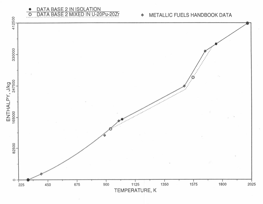

  1. Database 2 Used in Solid Phase
As described in Section B, U-Zr binary alloys of 5.4 to 37.6 wt % Zr content are used as database 2 in different regions as given in Table 10.3.1. The enthalpy data and correlations for 87 at.% U-Zr (U-5.4wt %Zr), U-10 wt %Zr, 59 at.% U-Zr (U-21.1wt %Zr), and 39 at.% U-Zr (U-37.6wt %Zr) presented in the Metallic Fuels Handbook have been correlated by Billone [10-12] into the following single equation with composition-dependent coefficients. Here the relationships between atom fractions and weight fractions were derived using an average atomic weight of 236.678 for U (based on a U-235 enrichment of 0.478 weight fraction as done by Billone for Mark-V fuel), an atomic weight of 91.22 from Zr, and an atomic weight of 239.13 for Pu.
(10.3-7)\[\begin{split}H_{\text{uz}} \left( T \right) = \begin{cases} \begin{aligned} & 1.594 \left( A_{\text{u}} + 0.3219 A_{\text{z}} \right) \left( T - 298 \right) \\ & + 0.03235 \left( A_{\text{u}} + 0.8495 A_{\text{z}} \right) \left( T^{2} - 298^{2} \right) \\ & + 928700 \left( A_{\text{u}} + 1.0243 A_{\text{z}} \right) \left( \frac{1}{298} - \frac{1}{T} \right) , & T \leq T_{\gamma} && \text{(10.3‑7a)} \\ & H_{\text{uz}} \left( T_{\gamma} \right) + 38.28 \left( A_{\text{u}} + 0.8203 A_{\text{z}} \right) \left( T - T_{\gamma} \right) , & T_{\gamma} < T \leq T_{\text{s}} && \text{(10.3‑7b)} \\ & H_{\text{uz}} \left( T_{\text{s}} \right) + 9142 \left( A_{\text{u}} + 5.938 A_{\text{z}} \right) \left( T - T_{\text{s}} \right) / \left( T_{\text{l}} - T_{\text{s}} \right) , & T_{\text{s}} < T \leq T_{\text{l}} && \text{(10.3‑7c)} \\ & H_{\text{uz}} \left( T_{\text{l}} \right) + 48.66 \left( A_{\text{u}} + 0.6885 A_{\text{z}} \right) \left( T - T_{\text{l}} \right) , & T > T_{\text{l}} && \text{(10.3‑7d)} \end{aligned} \end{cases}\end{split}\]
where
\(H_{\text{uz}} \left( T \right)\) = enthalpy (J/mol) of the U-Zr binary alloy at temperature T (K),
\(A_{\text{u}}, A_{\text{z}}\) = atom fractions of U and Zr in the alloy,
\(T_{\gamma}\) = the highest solid-state phase (\(\gamma\)-phase) transition temperature,
\(T_{\text{s}}\), \(T_{\text{l}}\) = solidus and liquidus temperatures of the U-Zr binary alloy.
For the U-Zr binary alloy, the temperatures \(T_{\gamma}\), \(T_{\text{s}}\) and \(T_{\text{l}}\) should be taken form the U-Zr phase diagram. For U-10 wt% Zr, the temperatures \(T_{\gamma}\), \(T_{\text{s}}\) and \(T_{\text{l}}\) are 1000 K, 1506 K and 1669 K. In the present method, Eq. (10.3-7) and Eq. (10.3-7) are never required. When mixed to form a desired U-Pu-Zr alloy composition, the temperatures \(T_{\gamma}\), \(T_{\text{s}}\) and \(T_{\text{l}}\) for the U-Pu-Zr ternary alloy are to be used in Eq. (10.3-7) as suggested by Billone [10-12]. In the present method, this amounts to (1) lowering \(T_{\gamma}\) from the U-Zr value of about 1000 K to the U-Pu-Zr alloy value of 923 K (see Table 10.3.1), and (2) extending Eq. (10.3-7) for U-Zr enthalpy in the γ-phase temperature range to the solidus temperature of the desired U-Pu-Zr alloy composition. This difference in behavior of four U-Zr alloys (database 2 alloys) when mixed to produce a desired alloy composition, e.g., U-20Pu-20Zr, as compared to their behavior in isolation is shown in Figure 10.3.12 to Figure 10.3.15. These plots also show the agreement between the enthalpy of U-Zr alloys in isolation, evaluated from this correlation, with the data in the Metallic Fuels Handbook [10-8].
  1. Database 3 Used in Solid Phase
As described in Section B, the Pu metal is used as database 3 in regions 2, 3, and 4. Region 1 does not require this database. The enthalpy data for Pu metal presented in the Metallic Fuels Handbook [10-8] has a number of solid-state phase transitions causing relatively small enthalpy jumps at the transition temperatures. As suggested by Billone [10-12], the following equation is a simplified representation of Pu metal enthalpy data [10-8], in the spirit of mixing to produce a desired U-Pu-Zr alloy composition (the value of the average Pu specific heat from the reference temperature of 298 K to Pu melting point of 913 K has been corrected):
(10.3-8)\[\begin{split}H_{\text{p}} \left( T \right) = \begin{cases} \begin{aligned} & 46.286 \left( T - 298 \right), & T \leq 913K && \text{(10.3‑8a)} \\ & H_{\text{p}} \left( 913 \right) + 34.434 \left( T - 913 \right) , & 913 < T \leq T_{\text{s}} && \text{(10.3‑8b)} \\ & H_{\text{p}} \left( 913 \right) + 34.434 \left( T - 913 \right) + 2824 \left( T - T_{\text{s}} \right) / \left( T_{\text{l}} - T_{\text{s}} \right), & T_{\text{s}} < T \leq T_{\text{l}} && \text{(10.3‑8c)} \\ & H_{\text{p}} \left( T_{\text{l}} \right) + 42.258 \left( T - T_{\text{l}} \right) & T > T_{\text{l}} && \text{(10.3‑8d)} \end{aligned} \end{cases}\end{split}\]
where
\(H_{\text{p}} \left( T \right)\) = enthalpy (J/mol) of Pu metal at temperature T,
913 K = the melting point of Pu metal
\(T_{\text{s}}\), \(T_{\text{l}}\) = solidus and liquidus temperatures of the desired U-Pu-Zr alloy composition, and not of pure Pu metal.
Here 46.286 J/mol-K is the average Pu specific heat between 298 K and 913 K, and 34.434 J/mol-K is the specific heat of the last solid-stat phase (\(\varepsilon\)-phase) of Pu metal that is extended up to the liquidus temperature of the desired U-Pu-Zr alloy composition to account for the sensible heat absorbed by Pu. Eq. (10.3-8) indicates that the Pu heat of fusion required for solid-to-liquid phase transition is added linearly between the solidus and liquidus temperatures of the desired U-Pu-Zr alloy composition. In the present method, Eq. (10.3-8) and Eq. (10.3-8) are never required. The difference in behavior of Pu metal when mixed to produce a desired alloy composition, e.g., U-20Pu-20Zr, as compared to its behavior in isolation is shown in Figure 10.3.16. This plot also shows the comparison between the enthalpy of Pu metal in isolation with the date in Metallic Fuels Handbook [10-8]. In Figure 10.3.16, the Pu enthalpy above the solidus temperature of the desired U-Pu-Zr alloy composition was obtained by linearly joining the enthalpy at solidus evaluated from Eq. (10.3-8) with the enthalpy at liquidus evaluated from Eq. (10.3-3) as mentioned in Section B.
It should be noted that the contribution of Pu enthalpy to U-Pu-Zr fuel compositions in the vicinity of U-15Pu-10Zr (point A of Figure 10.3.9) is small because the corner Pu of the ternary composition triangle is far removed from point A and the point representing the desired fuel composition. The major contribution comes from U-15Pu-10Zr enthalpy.

where
\({W'}_{\text{p}}, {W'}_{\text{z}}\) = weight fractions of Pu and Zr corresponding to any point on the line AF.
The Zr weight fraction of database alloy 2 is then found by setting \({W'}_{\text{p}} = 0\) in Eq. (10.3-23) because database 2 is a U-Zr binary alloy.
(10.3-24)\[x = W_{\text{z}1} - \frac{\left( W_{\text{z}} - W_{\text{z}1} \right)}{\left( W_{\text{p}} - W_{\text{p}1} \right)} W_{\text{p}1}\]
where
x = Zr weight fraction of database alloy 2 to be used in region 1.

10.3.2.1.5. Subroutine HFUEL1 and Specific Heat by Fuel Type
Figure 10.3.17 shows flow diagram of the subroutine HFUEL1 for calculating the enthalpy, based on this method of regionwise interpolation, of a U-Pu-Zr alloy fuel as a function of composition and temperature. The specific heat of each input fuel type of U-Pu-Zr alloy is evaluated using the 9 parameters defined in Figure 10.3.18 that are calculated using the subroutine HFUEL1 as described in this section. Figure 10.3.19 to Figure 10.3.22 show the comparison of calculated enthalpy with all the data in the Metallic Fuels Handbook for U-15Pu-10Zr and U-10Zr alloys, and U and Pu metals. Figure 10.3.23 to Figure 10.3.25 show the variation of U-Pu-Zr alloy fuel enthalpy with composition obtained from this subroutine. The Zr content varies from 2 to 20 wt % and the Pu content varies from 5 to 30 wt % in the U-Pu-Zr alloy fuels plotted in these figures. The solidus and liquidus temperature required as input to the HFUEL1 subroutine were calculated using the subroutine developed by Pelton [10-13].
The subroutine is used in the SAS4A/SASSYS-1 codes by the subroutine PRECAl (see flow diagram of Figure 10.3.7), before the steady state calculation, to pre-calculate coefficient of a simplified specific heat equation to be used in the steady state and transient calculations of the codes. These coefficients or parameters are defined in Figure 10.3.18, and are pre-calculated for each fuel type that use the regionwise interpolated U-Pu-Zr thermal properties (input option IFUELM=0). This pre-calculation of the coefficients or parameters of the simplified specific heat equation should increase the computational speed of the codes. For this pre-calculation, a sufficient number of pairs of temperature and enthalpy values for the pre-transition solid U-Pu-Zr alloy (see Figure 10.3.18) are obtained from the subroutine HFUEL1. The following enthalpy equation, basically a quadratic function of temperature that is constrained to exactly reproduce the first and last pairs of values, is then fitted by the method of least squares.

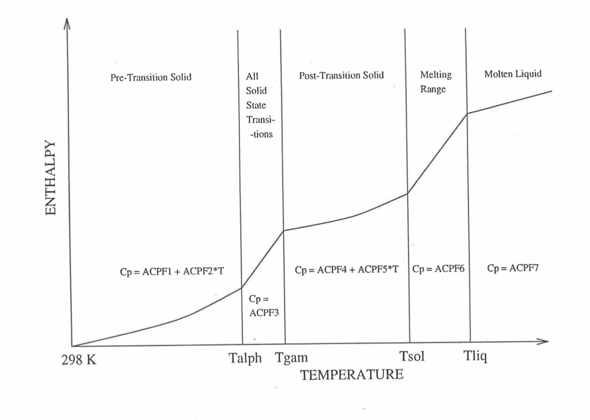

../../_images/image203.png
Figure 10.3.18 Diagram Showing the 9 Parameters (ACPF1 to ACPF7, and Solidus and Liquidus Temperatures) Pre-Calculated and Stored for Each U-PuZr Fuel Type for Fast Evaluation of Specific Heat.
../../_images/image216.png
Figure 10.3.19 Comparison of Calculated Enthalpy of U-Pu-10Zr Fuel With the IFR Metallic Fuels Handbook Data.
../../_images/image224.png
Figure 10.3.20 Comparison of Calculated Enthalpy of U-10Zr Fuel With the Handbook Data (Input KBASE to Subroutine HFUEL1-1).
../../_images/image235.png

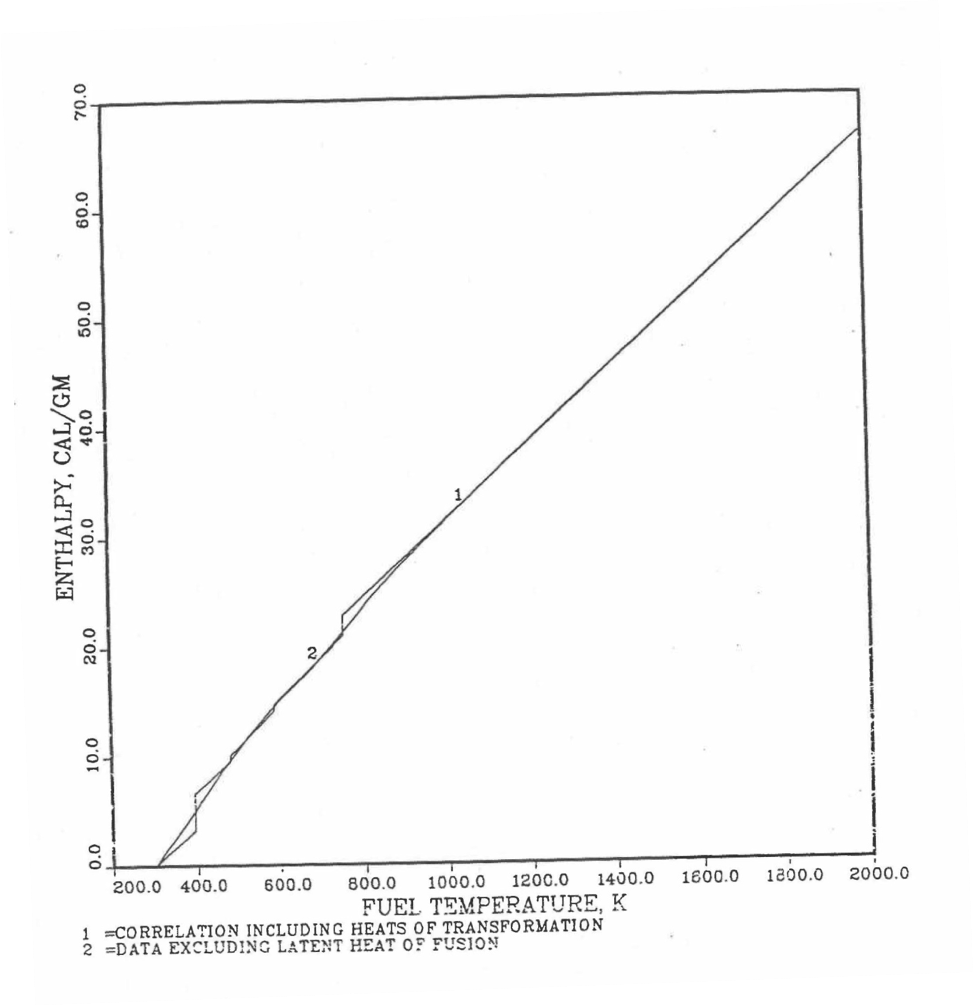

Figure 10.3.21 Comparison of Calculated Enthalpy of Uranium Metal with the IFR Metallic Fuels Handbook Data.
../../_images/image243.png
Figure 10.3.22 Comparison of Calculated Enthalpy of Plutonium Metal with the IFR Metallic Fuels Handbook Data.

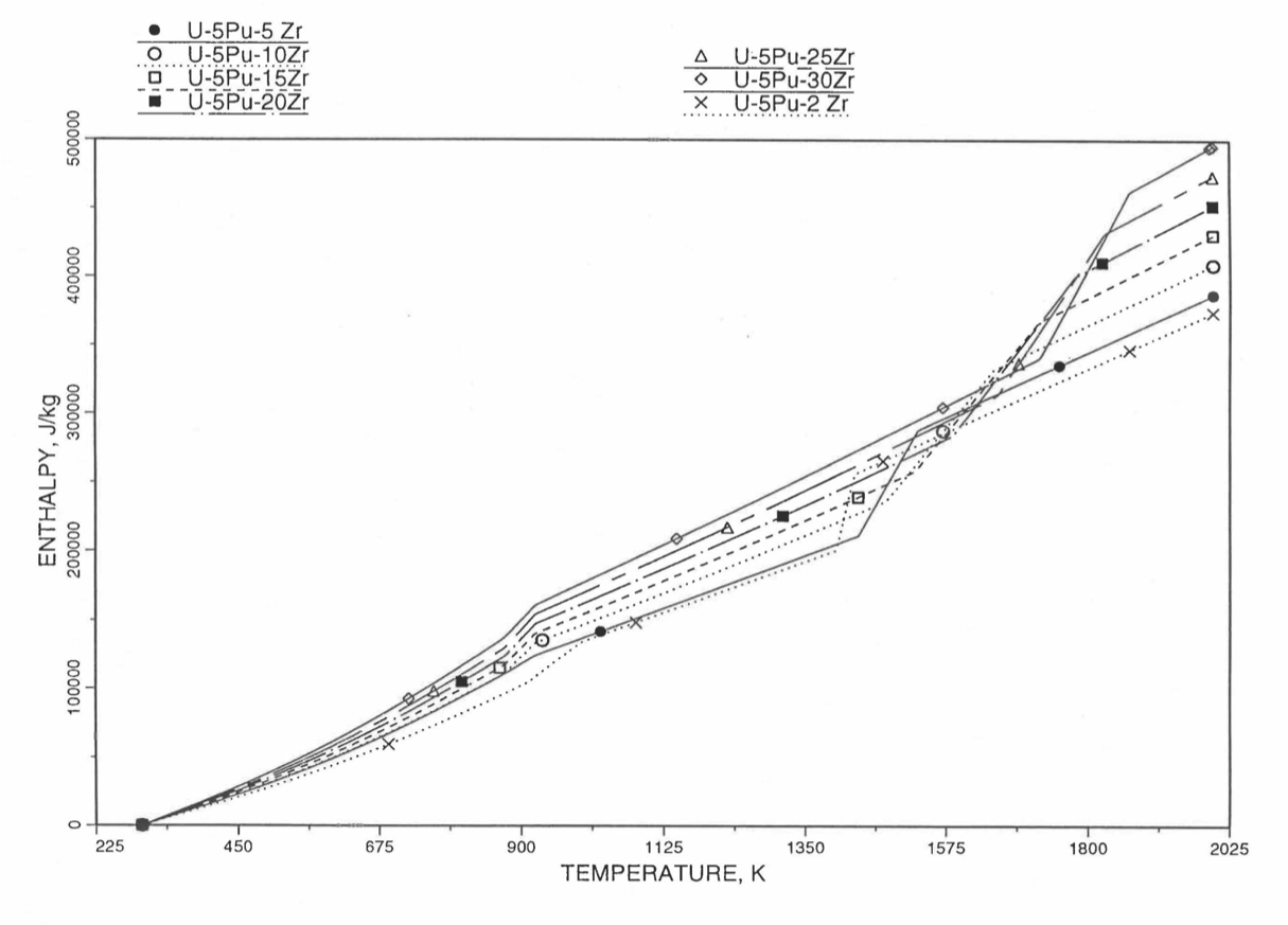

../../_images/image253.png
Figure 10.3.23 Variation of U-5Pu-Zr Alloy Fuel Enthalpy With Composition Obtained From Subroutine HFUEL1 Based on the Method of Regionwise Interpolation.

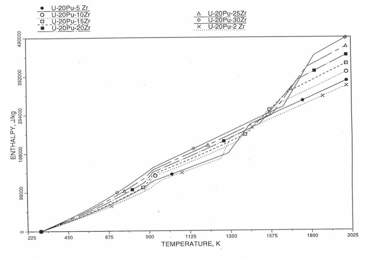

../../_images/image264.png
Figure 10.3.24 Variation of U-20Pu-Zr Alloy Fuel Enthalpy With Composition Obtained From Subroutine HFUEL1 Based on the Method of Regionwise Interpolation.

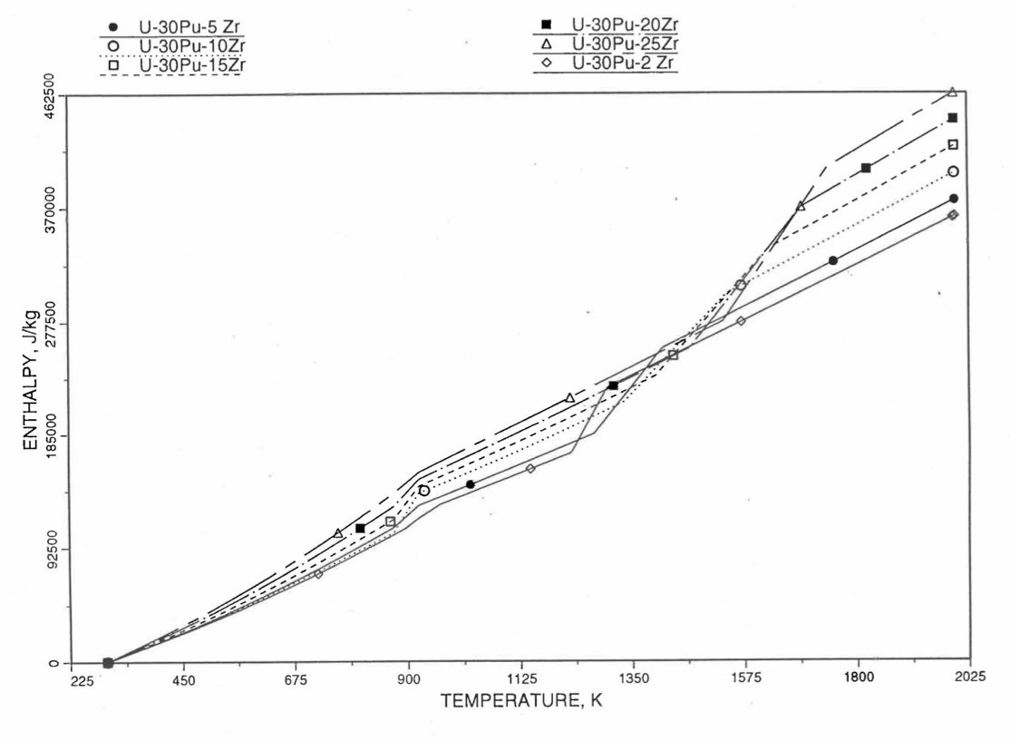

../../_images/image274.png
Figure 10.3.25 Variation of U-30Pu-Zr Alloy Fuel Enthalpy With Composition Obtained From Subroutine HFUEL1 Based on the Method of Regionwise Interpolation.
Minimizing the sum of squared errors, \({\sum_{\text{i} = 1}^{N}{\left\lbrack h \left( T_{\text{i}} \right) - h_{\text{i}} \right\rbrack}}^{2}\), one obtains the following value of the quadratic term coefficient.
(10.3-28)\[c = \frac{\sum_{\text{i}}{\left\lbrack h_{\text{i}} - f \left( T_{\text{i}} \right) \right\rbrack} \left( T_{\text{i}} - T_{1} \right) \left( T_{\text{i}} - T_{\text{N}} \right)}{\sum_{\text{i}} \left( T_{\text{i}} - T_{1} \right)^{2} \left( T_{\text{i}} - T_{\text{N}} \right)^{2}}\]
Differentiating Eq. (10.3-26) with respect to temperature, one obtains the following values of the coefficients of the simplified specific heat equation for the pre-transition solid U-Pu-Zr alloy (see Figure 10.3.18).
(10.3-29)\[C_{\text{p}} = \text{ACPF}1 + \text{ACPF}2*T\]
(10.3-30)\[\text{ACPF}1 = \frac{\left( h_{\text{N}} - h_{\text{i}} \right)}{\left( T_{\text{N}} - T_{1} \right)} - c \left( T_{1} + T_{\text{N}} \right)\]
(10.3-31)\[\text{ACPF}2 = 2C\]
The least-squares fitting procedure is repeated for the post-transition solid U-Pu-Zr alloy (see Figure 10.3.18) to obtain the coefficients its simplified specific heat equation. In each of the remaining temperature ranges of Figure 10.3.18, the specific heat is assumed to be a constant.
It is important to note that, in order to be consistent with the method of Section 3.3.5 for adjusting fuel temperature (computed without accounting for heat of fusion during the main heat transfer calculation) to account for heat of fusion at any radial mesh interval that is going through the melting range, the actual specific heat ACPF6 (see Figure 10.3.18) over the melting range is replaced in subroutine CFUEL by a value linearly interpolated between (i) the post-transition solid U-Pu-Zr specific heat at the solidus temperature, and (ii) the molten liquid solution specific heat, ACPF7, at the liquidus temperature.
This approach of calculating U-Pu-Zr fuel specific heat by fuel type is used only in case of a single radial fuel zone (IFUELC=0), or multiple (i.e., up to 3) radial fuel zones (IFUELC=1). When each fuel radial mesh interval is a unique zone of a different alloy composition (IFUELC=2), then use is made of another subroutine CFUEL1 that calculates U-Pu-Zr alloy specific heat as a function of composition, directly by regionwise interpolation of the temperature-derivative of enthalpies of database alloys, as described in the next section.

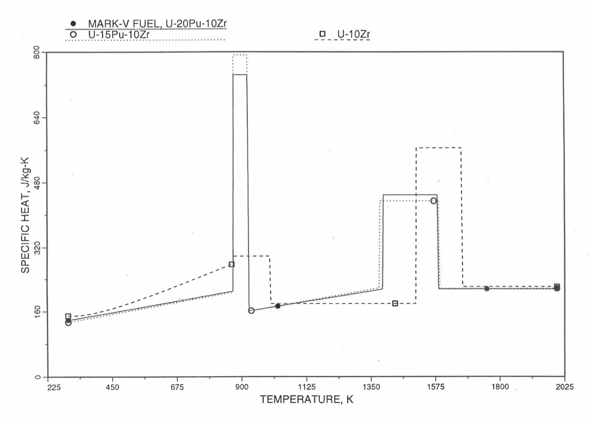

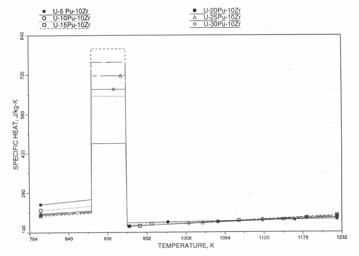

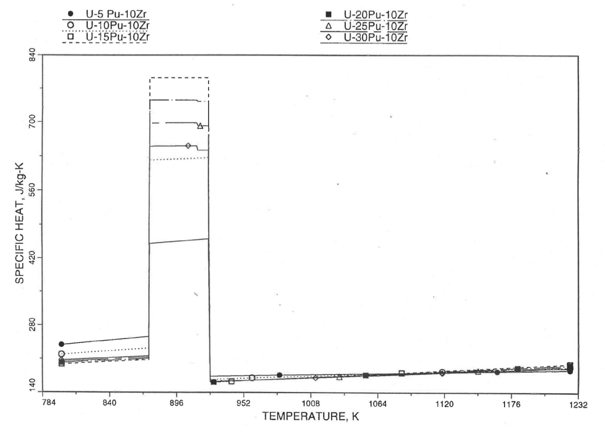

Figure 10.3.20 shows the variation of Mark-V (U-20Pu-10Zr), U-15Pu-10Zr and U-10Zr fuel specific heats with temperature, obtained from this subroutine. Figure 10.3.31 to Figure 10.3.36 show the variation of U-Pu-Zr alloy fuel specific heat with composition. The Zr content varies from 2 to 25 wt %, and the Pu content varies from 5 to 30 wt % in the U-Pu-Zr alloy fuels plotted in these figures. Figure 10.3.32, Figure 10.3.34 and Figure 10.3.36 simply show an enlargement of the solid-stat transition region of Figure 10.3.31, Figure 10.3.33 and Figure 10.3.35. The solidus and liquidus temperatures required as input to the CFUEL1 subroutine were obtained using the subroutine developed by Pelton [10-13].

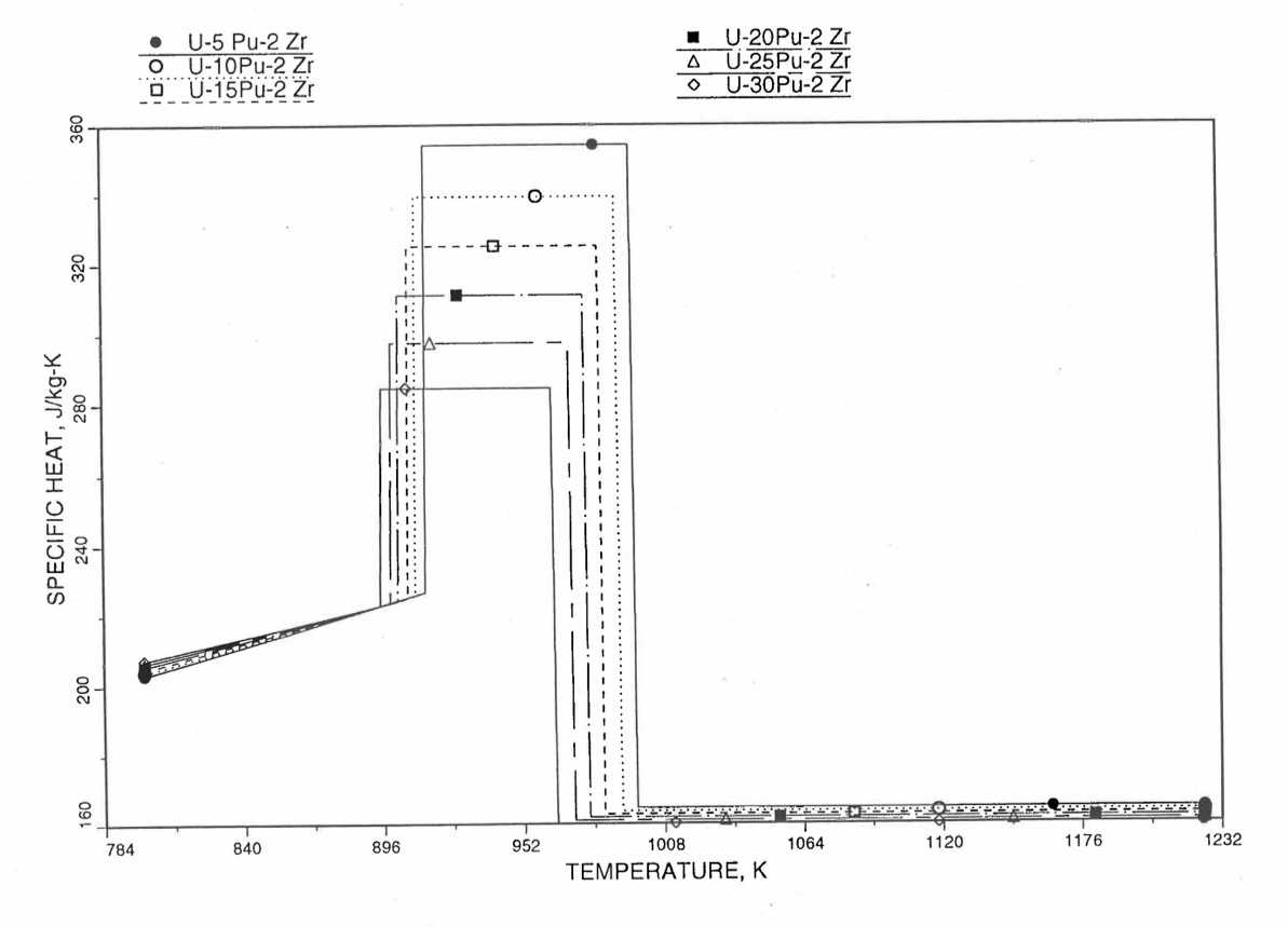

../../_images/image293.png
Figure 10.3.27 Detailed Variation of U-Pu-2Zr Fuel Specific Heat Obtained by Regionwise Interpolation of Metallic Fuels Handbook Data.

../../_images/image322.png
Figure 10.3.30 Specific Heat of Mark-V (U-20Pu-10Zr) Fuel Obtained by Regionwise Interpolation of Metallic Fuels Handbook Data.

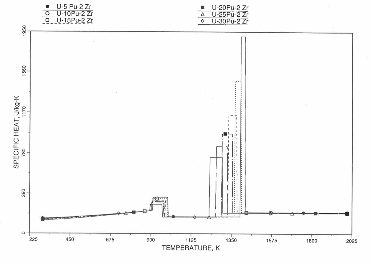

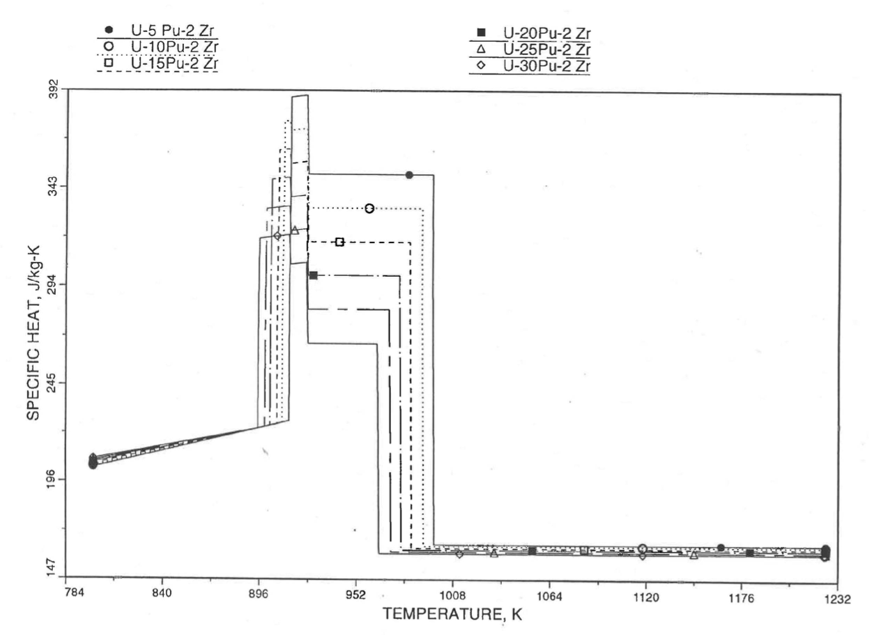

../../_images/image332.png
Figure 10.3.31 Specific Heat of U-Pu-2Zr Alloy Fuel Obtained By Regionwise Interpolation of Metallic Fuels Handbook Data.
../../_images/image342.png
Figure 10.3.32 Specific Heat of U-Pu-2Zr Alloy Fuel Obtained by Regionwise Interpolation of Metallic Fuels Handbook Data (Enlarged).

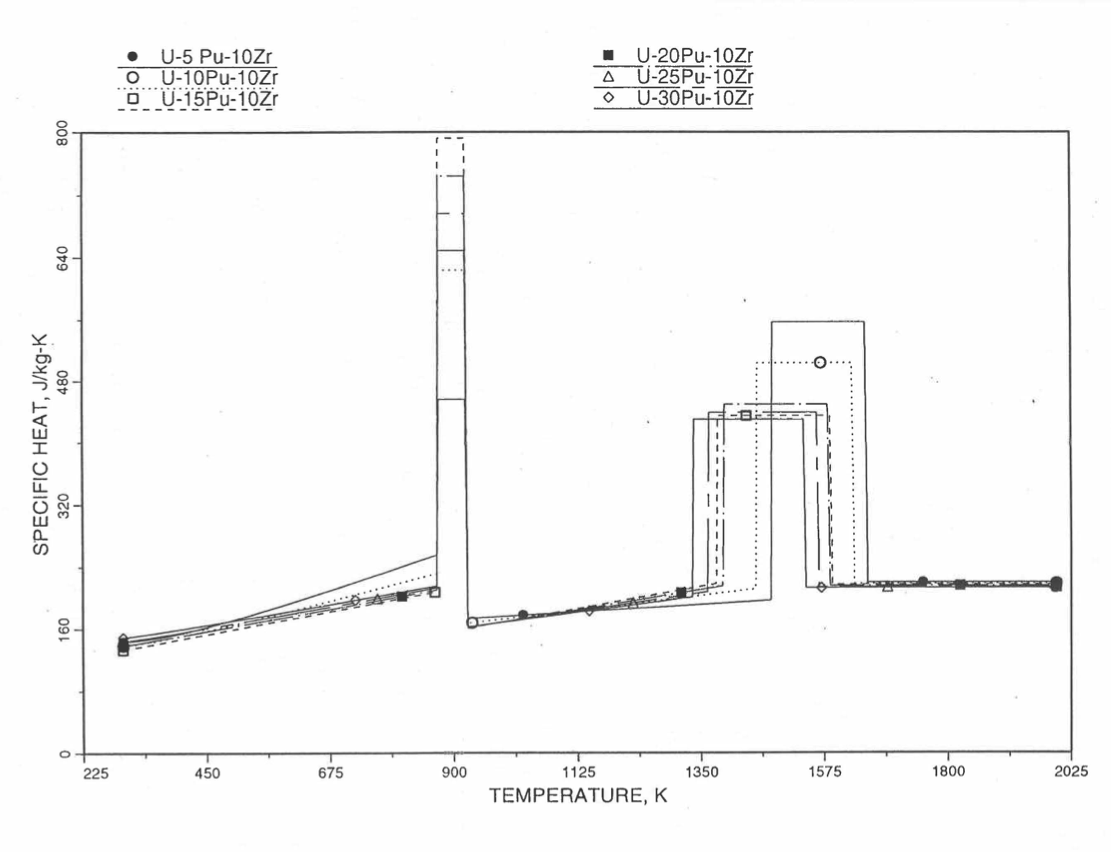

../../_images/image352.png
Figure 10.3.33 Specific Heat of U-Pu-10Zr Alloy Fuel Obtained by Regionwise Interpolation of Metallic Fuels Handbook Data.
../../_images/image362.png
Figure 10.3.34 Specific Heat of U-Pu-10Zr Alloy Fuel Obtained by Regionwise Interpolation of Metallic Fuels Handbook Data (Enlarged).

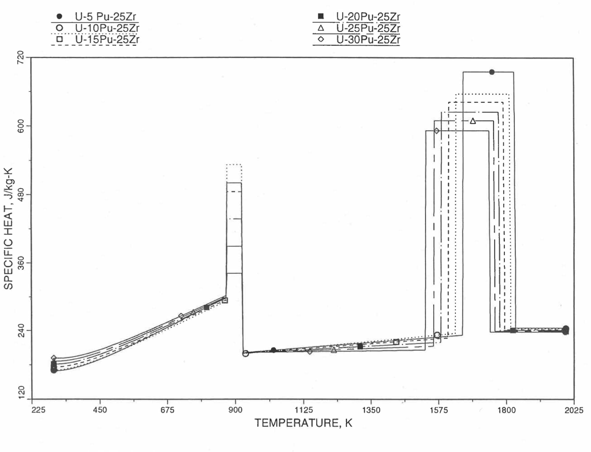

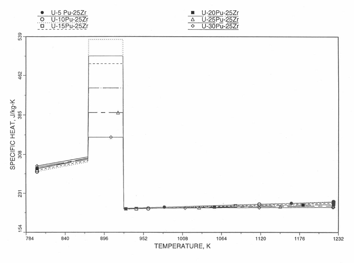

../../_images/image372.png
Figure 10.3.35 Specific Heat of U-Pu-25Zr Alloy Fuel Obtained by Regionwise Interpolation of Metallic Fuels Handbook Data.

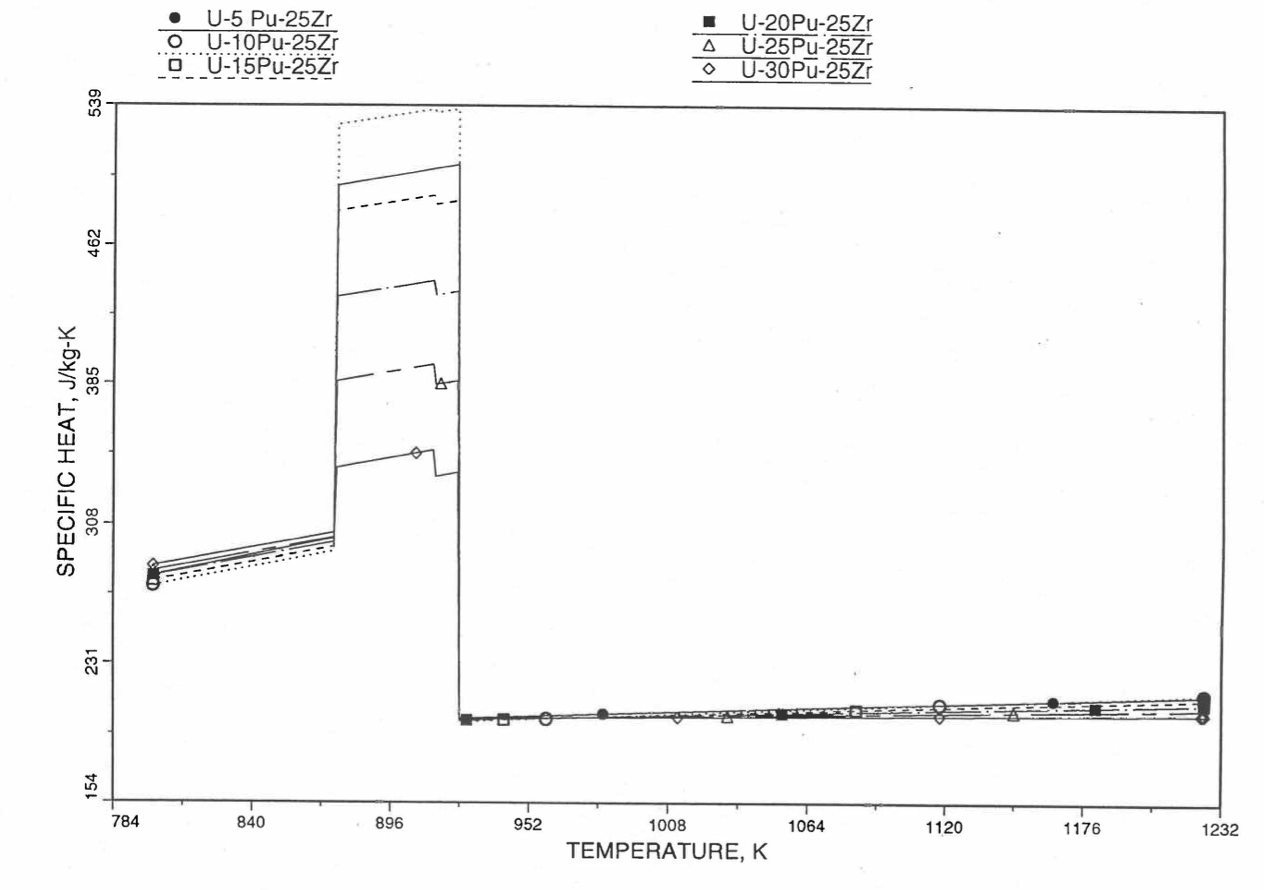

../../_images/image381.png
Figure 10.3.36 Specific Heat of U-Pu-25Zr Alloy Fuel Obtained by Regionwise Interpolation of Metallic Fuels Handbook Data (Enlarged).

Eq. (10.3-42) and Eq. (10.3-43) give the theoretical density of irradiated U-Pu-Zr fuel at a fixed temperature of 293K. In the next section, a method of interpolating the linear thermal expansion from 293K to any desired temperature T as a function of fuel composition is described. Using this thermal expansion, the following equation can be written for the theoretical density of irradiated U-Pu-Zr fuel at any desired temperature T:
(10.3-44)\[\rho_{\text{th}} \left( \text{Bu}, T, W_{\text{p}}, W_{\text{z}} \right) = \frac{\left( 1 + 0.009991 f_{\text{o}} \right)\left\lbrack 1 + \Delta L \left( T, W_{\text{p}}, W_{\text{z}} \right) / \text{Lo} \right\rbrack^{-3}}{\left( \frac{W_{\text{u}}}{19070} + \frac{W_{\text{p}}}{19750} + \frac{W_{\text{z}}}{6570} \right) + 1.7144 \times 10^{-6} f_{\text{o}}}\]
where
\(\Delta L \left( T, W_{\text{p}}, W_{\text{z}} \right) / L_{\text{o}}\) = linear thermal expansion from 293K to temperature T, expressed as a fraction of length \(L_{\text{o}}\) at the temperature 293K, for a U-Pu-Zr alloy with U, Pu, and Zr weight fractions equal to \(W_{\text{u}}, W_{\text{p}}\) and \(W_{\text{z}}\).

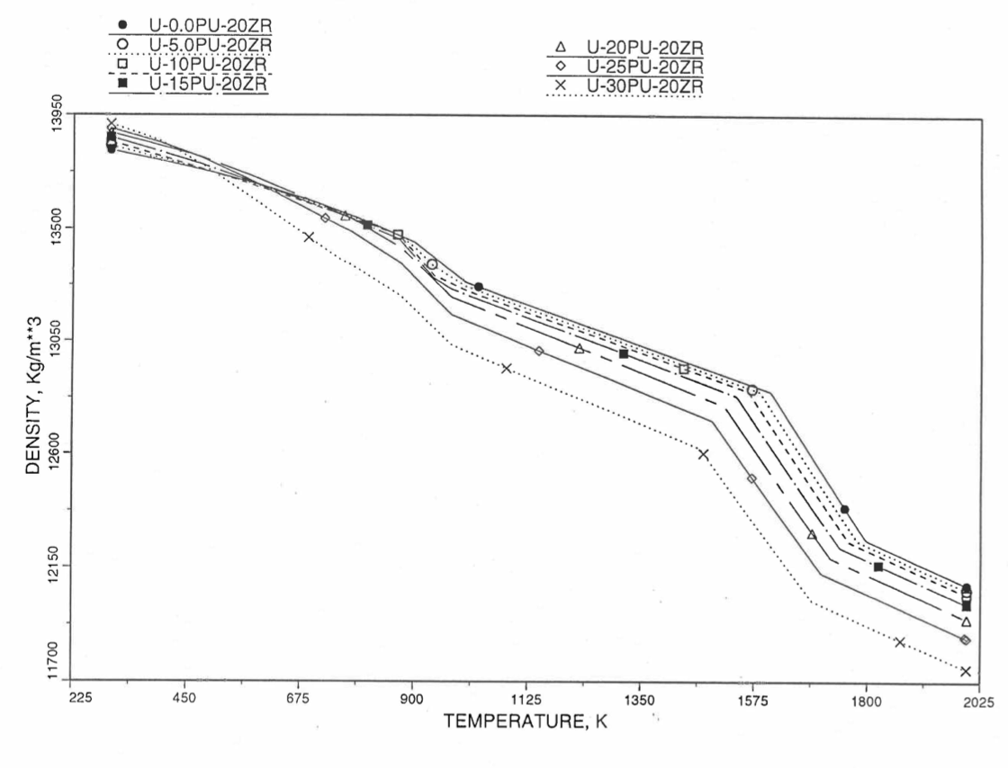

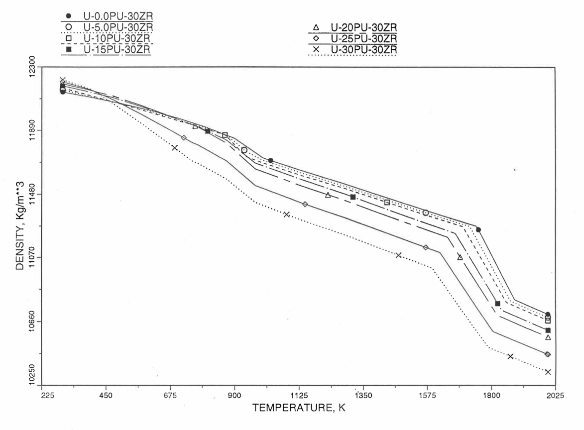

Figure 10.3.37 shows the flow diagram of a subroutine RHOFM for calculating the theoretical density, based on this method, of irradiated U-Pu-Zr alloy fuel as a function of composition and temperature. For improving the computational speed of the SAS4A/SASSYS-1 codes, the theoretical density without fission products at 293K of each U-Pu-Zr fuel type (that uses the regionwise interpolation thermal properties, i.e., input option IFUELM = 0) is precalculated in subroutine PRECAL before steady state calculation, and used later in the steady state and transient calculation of the codes.

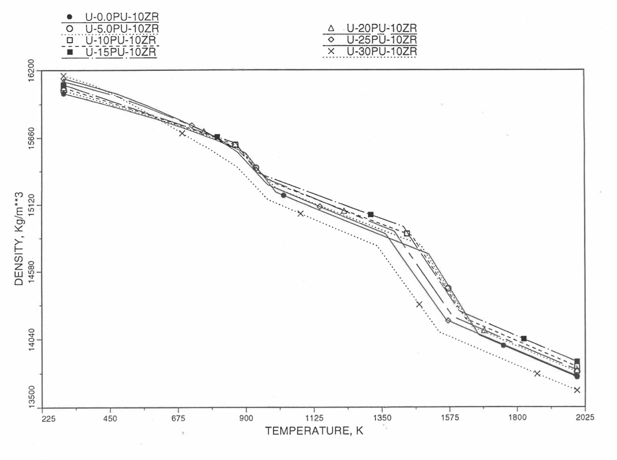

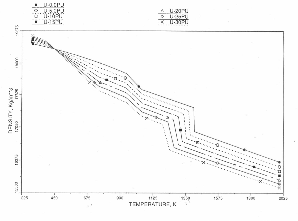

Figures (Figure 10.3.38) to (Figure 10.3.41) show the variation of theoretical density (without fission products) with temperature for 28 alloy compositions, calculated using Eq. (10.3-44). The thermal expansion required on the right hand side of Eq. (10.3-44) was obtained using the subroutine THEXP1 described below. The Pu and Zr contents each vary from zero to 30 at % in the alloy compositions plotted in these figures.
../../_images/image392.png
Figure 10.3.37 Flow Diagram of subroutine PHOFM for U-Pu-Zr Fuel Theoretical Density.
../../_images/image402.png
Figure 10.3.38 Theoretical Density of U-Pu Fuel Without Fission Products, Obtained from Regionwise Interpolation.
../../_images/image412.png
Figure 10.3.39 Theoretical Density of U-Pu-10Zr Fuel Without Fission Products, Obtained From Regionwise Interpolation of IFR Handbook Data.
../../_images/image422.png
Figure 10.3.40 Theoretical Density of U-Pu-20Zr Fuel Without Fission Products, Obtained from Regionwise Interpolation of IFR Handbook Data.
../../_images/image432.png
Figure 10.3.41 Theoretical Density of U-Pu-30Zr Fuel Without Fission Products, Obtained from Regionwise interpolation of IFR Handbook Data.

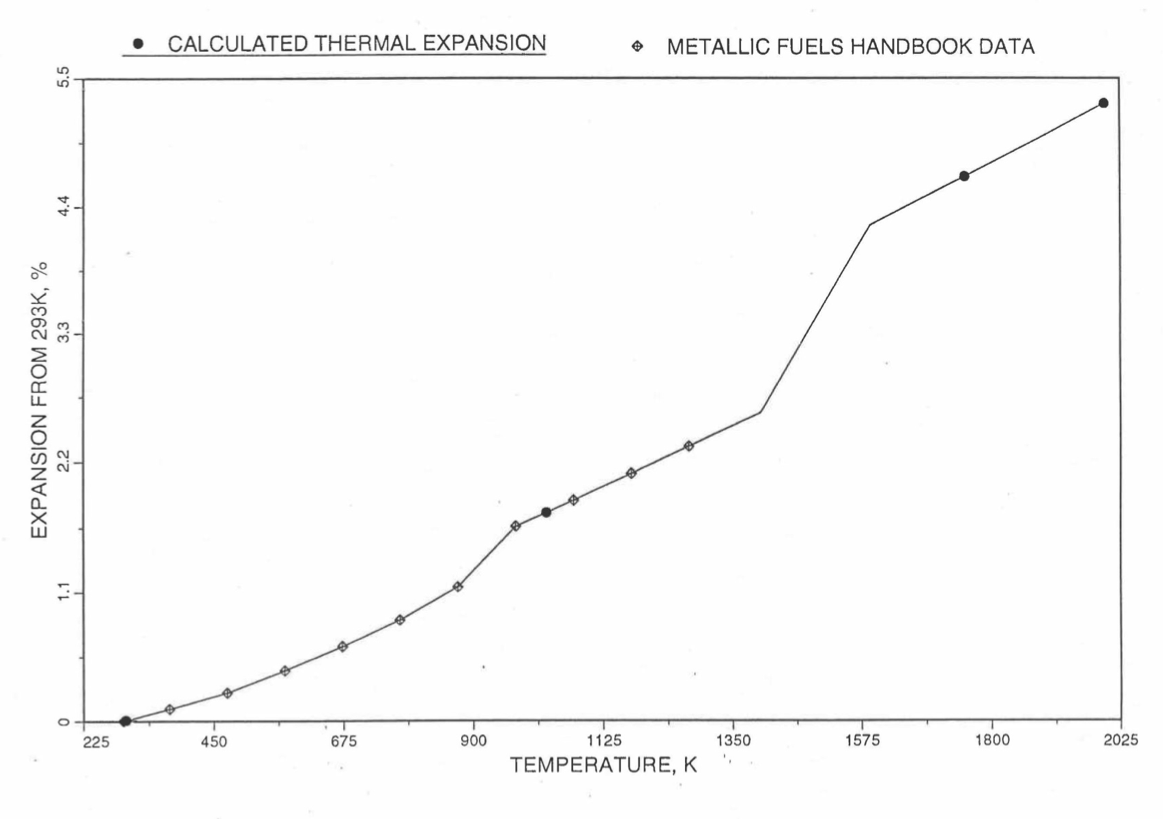

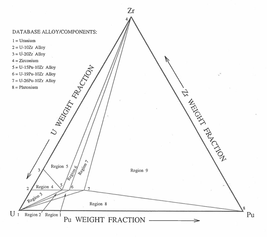

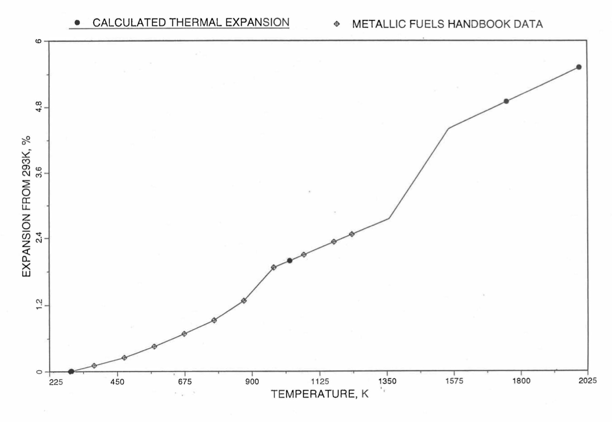

10.3.2.4. Thermal Expansion of U-Pu-Zr Fuel
In this section, a method of interpolating the linear thermal expansion of U-Pu-Zr fuel form 293K to any desired temperature T as a function of fuel composition is described. Only the U, Pu and Zr weight fractions are considered and the effect of fission products on thermal expansion is ignored. This thermal expansion is used in the evaluation of theoretical density of irradiated U-Pu-Zr fuel at any desired temperature, as explained in Section 10.3.2.3.
10.3.2.4.1. Description of the Method
Figure 10.3.42 shows the U-Pu-Zr ternary composition triangle marked with the points representing all the 8 alloys/components for which thermal expansion data re reported in the IFR Handbook [10-8]. The composition points of these 8 database alloys/components are used to divide the whole ternary composition triangle into 9 triangular regions of interpolation. For evaluating the linear thermal expansion of a desired solid U-Pu-Zr alloy represented by a point located in any region of interpolation, the method consists of mixing the 3 database alloys represented by the corners of the region of interpolation. The proportions or weight fractions of the 3 database alloys in mixing are so calculated in the method that the resulting mixture has the composition of the desired alloy. The calculated mixing fractions are then used as weight factors in making a linear combination of (or liner interpolation between) thermal expansions of the 3 database alloys corresponding to the desired temperature, and the value of the linear combination is the interpolated thermal expansion of the desired alloy. It should be noted that the calculated mixing fractions are never negative and the linear combination never requires extrapolation because the desired alloy composition point is always inside the triangle with corners at the 3 database alloy points. If the desired alloy composition point were outside this triangle, the linear combination would involve negative mixing fractions and extrapolation which are avoided entirely in the present method.
../../_images/image442.png
Figure 10.3.42 Diagram Showing Thermal Expansion Interpolation Regions for Solid U-Pu-Zr Alloy Fuels.
10.3.2.4.2. Thermal Expansion Data of Basic Alloys
Table 10.3.3 gives the linear thermal expansion data of the 8 basic solid alloys or components that are used in the present method of evaluating composition-dependent thermal expansion of a U-Pu-Zr alloy. The 8 basic alloys/components are: (1) U metal, (2) U-10Zr, (3) U-20Zr, (4) Zr metal, (5) U-15Pu-10Zr, (6) U-19Pu-10Zr, (7) U-26Pu-10Zr, and (8) Pu metal. The data have all been taken from the Metallic Fuels Handbook [10-8] with the modification that the thermal expansion data of U, Pu and Zr metals between their first and last solid-state transition temperatures are not included in Table 10.3.3, and not used in the present method. The thermal expansion data of U, Pu and Zr metals at their first and last transition temperatures are included in Table 10.3.3, and the thermal expansion is assumed to vary linearly with temperature between the first and last transition temperatures. This is reasonable because the sharp jumps (i.e., discontinuities) in thermal expansion data of U, Pu and Zr metals, over the temperature range of solid-state transitions, are not exhibited by alloys. The value of thermal expansion at 2500K shows in Table 10.3.3, for each database alloy/component has been obtained from the Handbook data for percent thermal expansion and coefficient of thermal expansion at the highest temperature available. A warning message is printed by the SAS4A/SASSYS-1 codes if the thermal expansion value at 2500K of any database alloy is ever used in computation. The uranium thermal expansion data at 1500K, 1600K and 2500K (above its melting point) in Table 10.3.3 have been obtained by subtracting the thermal expansion due to melting (i.e., 1.14%) from the data given in the Handbook. This is done because the data in Table 10.3.3 is used in the present method to interpolate the thermal expansion of a desired U-Pu-Zr alloy up to its solidus temperature only. The evaluation of thermal expansion above the solidus temperature is described below in Section D.
10.3.2.4.3. Method of Interpolation
The method of interpolation to evaluate the linear thermal expansion of a U-Pu-Zr fuel composition at and below its solidus temperature consists of first determining the region of the ternary composition triangle (shown in Figure 10.3.42) in which the desired fuel composition lies, and then finding the weight fractions in which the 3 database alloys of the region are required to be mixed to obtain the desired fuel composition. From the mass balance of U, Pu and Zr, the following equations have been obtained in Section 10.3.2.1 for the mixing fractions, \(X_{\text{i}}\), of the database alloys that are assumed to be numbered 1, 2 and 3:

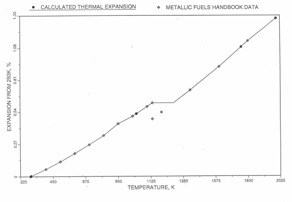

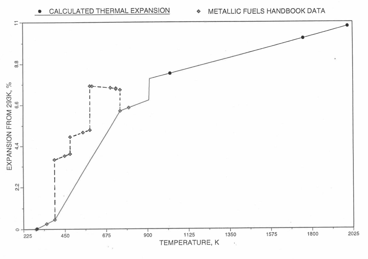

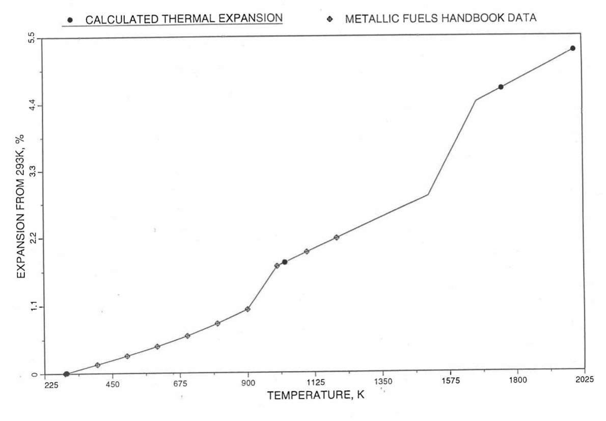

10.3.2.4.5. Subroutine THEXP1 and its Comparison With the Handbook Data

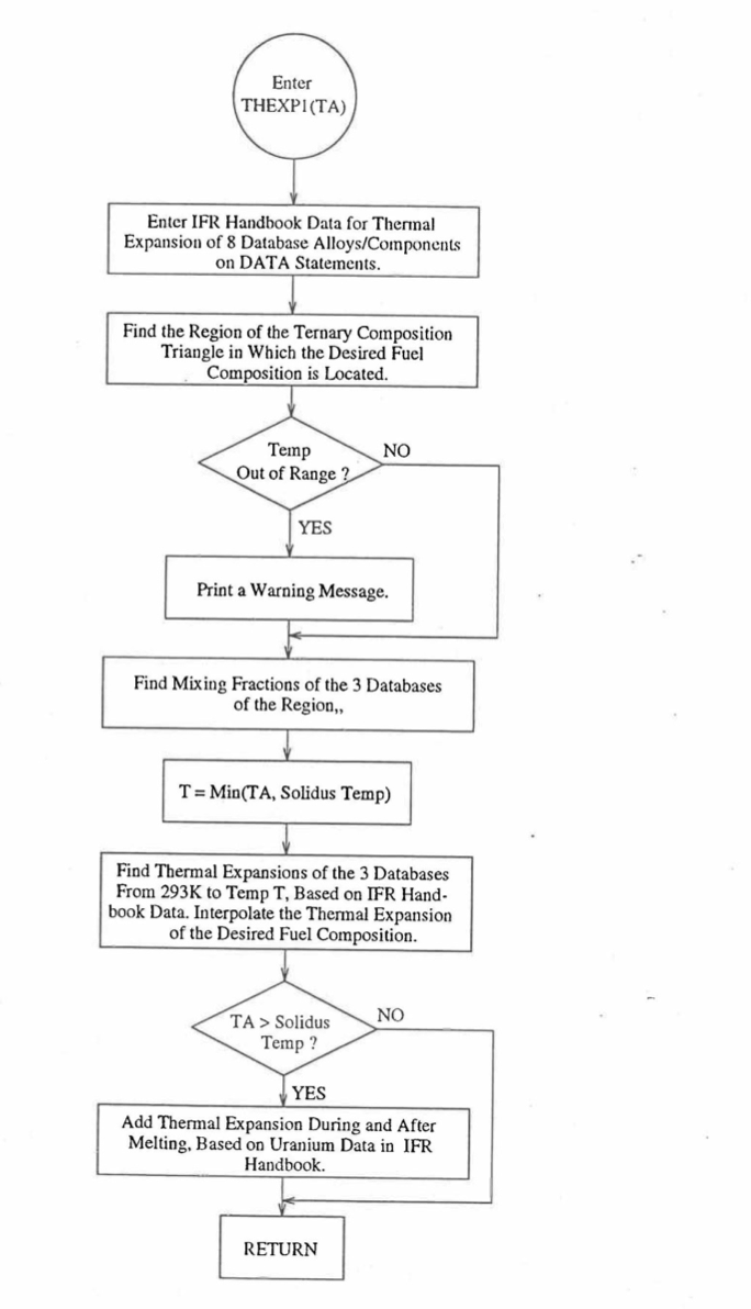

Figure 10.3.43 shows flow diagram of the subroutine THEXP1 developed for calculating the linear thermal expansion, based on this method of regionwise interpolation, of U-Pu-Zr fuel as a function of composition. This subroutine is used, in the SAS4A/SASSYS-1 codes, in the calculation of the theoretical density as a function of temperature and composition, given by Eq. (10.3-44).

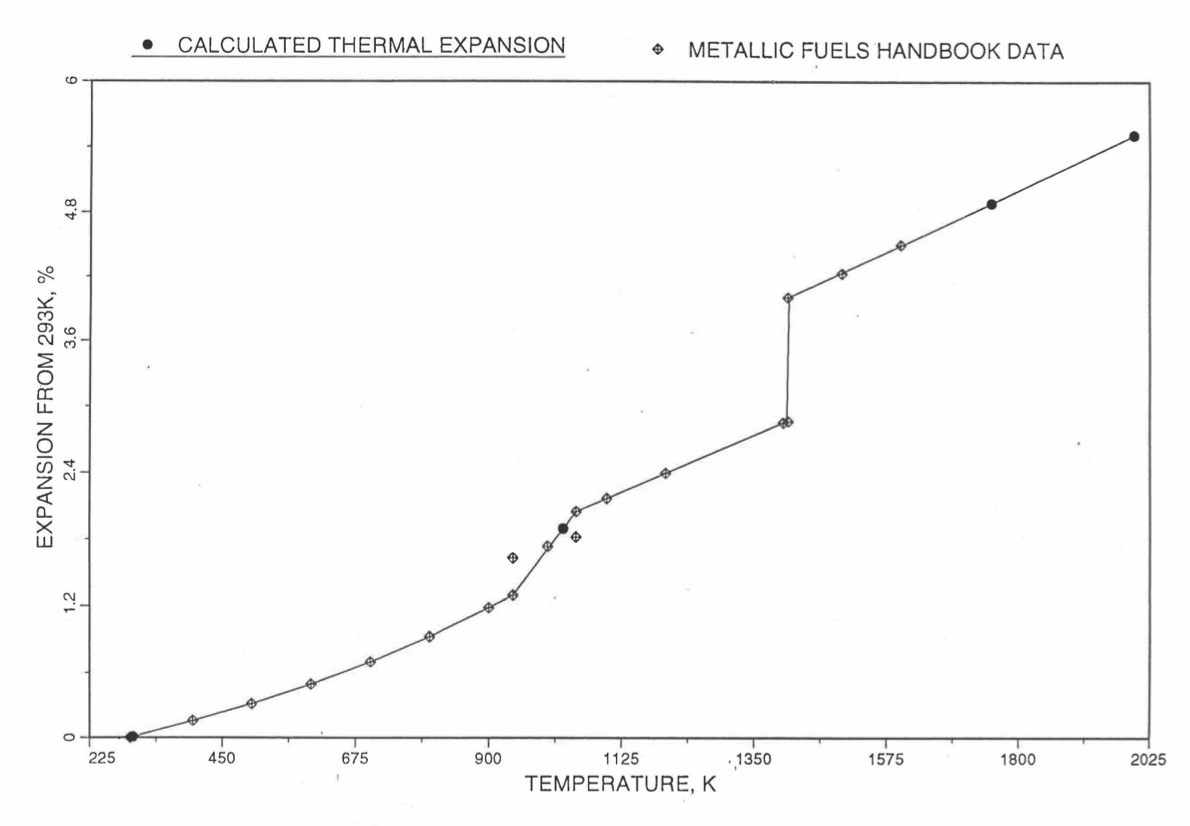

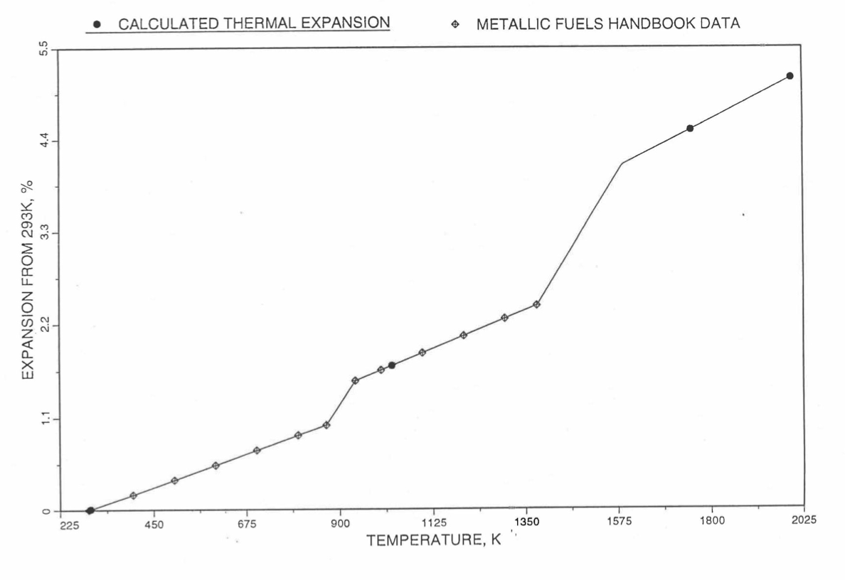

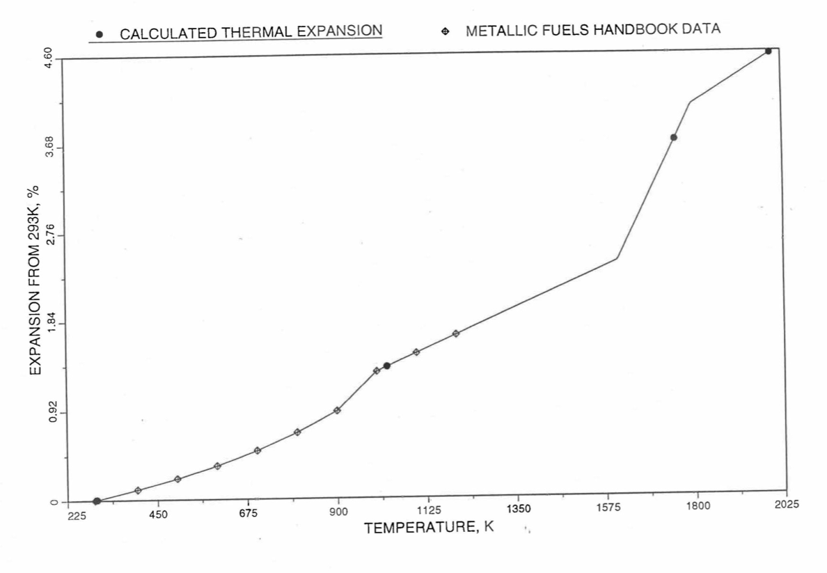

Figure 10.3.44 to Figure 10.3.51 show the comparison of calculated linear thermal expansion with all the data in the Metallic Fuels Handbook [10-8] for the 8 basic alloys or components discussed in Section B. It can be noted in Figure 10.3.44, Figure 10.3.47 and Figure 10.3.51 that the Handbook data for U, Zr and Pu metals over the solid-state transition temperature range differ from the calculated values. As discussed in Section B, the calculated thermal expansion varies linearly with temperature between the first and last solid state transitions. In the case of Zr and Pu (Figure 10.3.47 and Figure 10.3.51), this linearization has led to ignoring the thermal contractions (taking place during heatup) that occur at solid state transitions. However the behavior of the 3 metals when alloyed is different from their behavior in isolation, and the linearization is the expected behavior when alloyed.

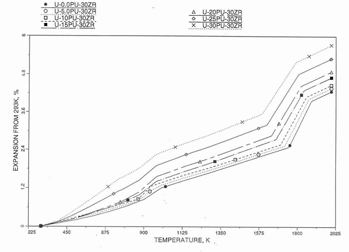

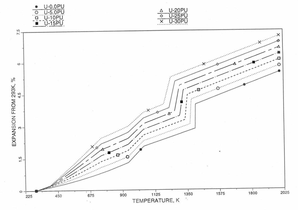

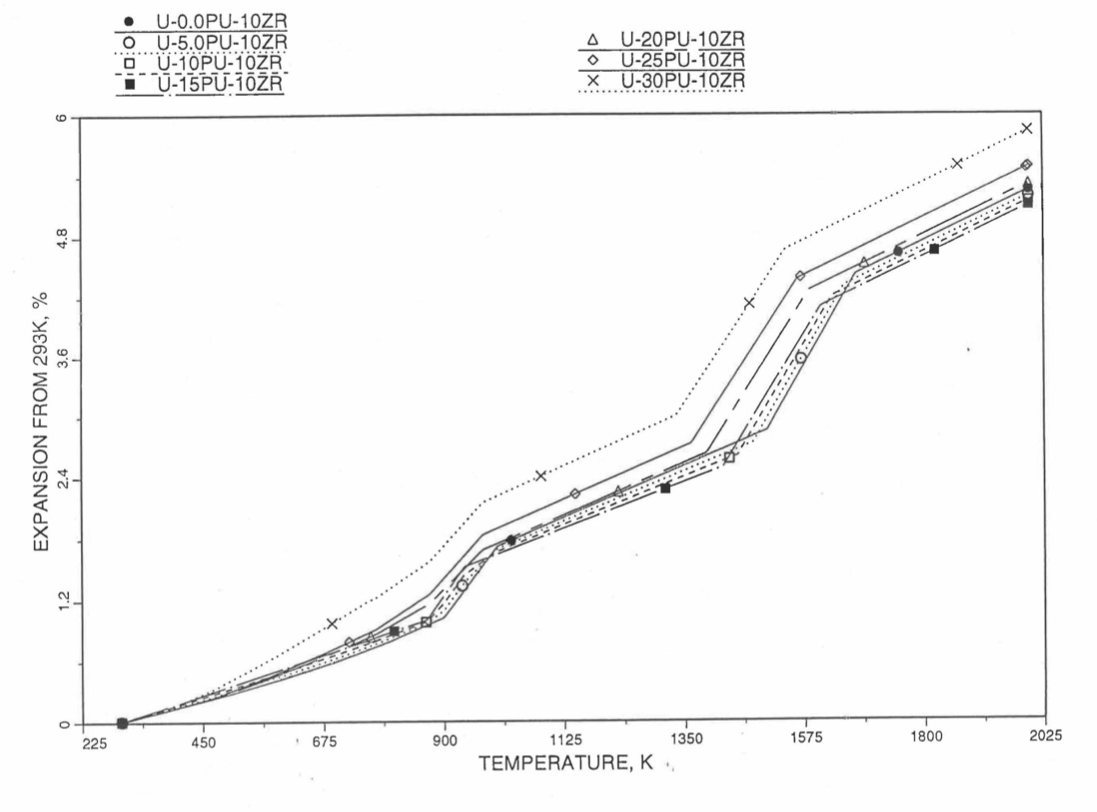

Figure 10.3.52 to Figure 10.3.54 show the variation of linear thermal expansion with temperature for 21 alloy compositions obtained from this subroutine. The Pu and Zr contents each vary from zero to 30 wt % in the alloy compositions plotted in the figures. The solidus and liquidus temperatures required as input to the THEXP1 subroutine were calculated using another subroutine developed by Pelton [10-13]. The linear thermal expansion from 293K to solidus varies over the range 2.4% to 4.0% for the alloy compositions plotted.

Figure 10.3.43 Flow Diagram of Subroutine THEXP2 for U-Pu-Zr Thermal Expansion.
../../_images/image461.png
Figure 10.3.44 Comparison of Uranium Metal Linear Thermal Expansion Data in IFR Handbook With Those Calculated by the Regionwise Interpolation Subroutine THEXP1.
../../_images/image471.png
Figure 10.3.45 Comparison of U-10Zr Alloy Linear Thermal Expansion Data in IFR Handbook With Those Calculated by the Regionwise Interpolation Subroutine THEXP1.
../../_images/image48.png
Figure 10.3.46 Comparison of U-20Zr Alloy Linear Thermal Expansion Data in IFR Handbook With those Calculated by the Regionwise Interpolation Subroutine THEXP1.
../../_images/image49.png
Figure 10.3.47 Comparison of Zirconium Metal Linear Thermal Expansion Data in IFR Handbook With Those Calculated by the Regionwise Interpolation Subrountine THEXP1.
../../_images/image50.png
Figure 10.3.48 Comparison of U-15Pu-10Zr Linear Thermal Expansion Data in IFR Handbook With Those Calculated by the Regionwise Interpolation Subroutine THEXP1.
../../_images/image511.png
Figure 10.3.49 Comparison of U-19Pu-10Zr Linear Thermal Expansion Data in IFR Handbook With Those Calculated by the Regionwise Interpolation Subroutine THEXP1.
../../_images/image521.png
Figure 10.3.50 Comparison of U-26Pu-10Zr Linear Thermal expansion Data in IFR Handbook With those Calculated by the Regionwise Interpolation Subroutine THEXP1.
../../_images/image531.png
Figure 10.3.51 Comparison of Plutonium Metal Liner Thermal Expansion Data in IFR Handbook With Those calculated by the Regionwise Interpolation Subroutine THEXP1.
../../_images/image541.png
Figure 10.3.52 Linear Thermal Expansion of U-Pu Fuel Without Fission Products, Obtained From Regionwise Interpolation of IFR Handbook Data.

Figure 10.3.53 Linear Thermal Expansion of U-Pu-10Zr fuel Without Fission Products, Obtained From Regionwise Interpolation of IFR Handbook Data.
../../_images/image56.png
Figure 10.3.54 Linear Thermal Expansion of U-Pu-30Zr Fuel Without Fission Products, Obtained From Regionwise Interpolation of IFR Handbook Data.

../../_images/image57.png
Figure 10.3.55 Diagram Showing Thermal Conductivity Interpolation Regions for 100% Dense Solid U-Pu-Zr Fuels.
10.3.2.5.2. Description of the Method
Figure 10.3.55 shows the U-Pu-Zr ternary composition triangle marked with the points representing 9 basic alloys/components comprising of all the thermal conductivity data reported in the IFR Handbook [10-8, 10-9]. The U-10Pu data used here are obtained from Billone [10-21], and the Pu data are reported in the Plutonium Handbook [10-23], and a warning message is printed by the codes when these two data are actually used in any calculation. The composition points of these 9 database alloys/components are used to divide the whole ternary composition triangle into 10 triangular regions of interpolation as shown in Figure 10.3.55. For evaluating the thermal conductivity of a desired solid U-Pu-Zr alloy represented by a point located in any region of interpolation, the method consists of mixing the 3 database alloys represented by the corners of the region of interpolation. The proportions or weight fractions of the 3 database alloys in mixing are so calculated in the method that the resulting mixture has the composition of the desired alloy. The calculated mixing fractions are then used as weight factors in making a linear combination of (or linear interpolation between) thermal conductivity data of the 3 database alloys, and the linear combination gives the interpolated thermal conductivity of the desired alloy. The thermal conductivity data of each basic alloy/component are least-square fitted by aquadratic function of temperature.
(10.3-52)\[K_{\text{0i}} = A_{\text{i1}} + A_{\text{i2}} T + A_{\text{i3}} T^{2}\]
where
\(K_{\text{0i}}\) = thermal conductivity of the ith 100%-dense solid database alloy/component, W/m-K,
\(A_{\text{i1}}, A_{\text{i2}}, A_{\text{i3}}\) = coefficients of the quadratic for the thermal conductivity of the ith database alloy,
\(T\) = alloy temperature, K.
The interpolation of the thermal conductivity data of the 3 basic alloys is performed by interpolating between the coefficients (of like terms) of the quadratics for the 3 basic alloys. The calculated mixing fractions are never negative and the linear combination never requires extrapolation because the desired alloy composition point is always inside the triangle with corners at the 3 database alloy points. If the desired alloy composition point were outside this triangle, the linear combination would involve negative mixing fractions and extrapolation which are avoided entirely in the present method.
A different method of interpolation is used in region 3 (Figure 10.3.55) in order to employ the Handbook U-Zr binary correlation for composition points on the side joining corners 2 and 3, i.e., for binary compositions containing 1.5 to 20 wt % Zr. This is done because the Handbook binary correlation Eq. (10.7-12) with Pu content set to zero) is accurate for Zr content in this range, as discussed in Section 10.7.1. The thermal conductivity of a desired U-Pu-Zr alloy in region 3 (represented by point F in Figure 10.3.55) is interpolated between only two compositions, the database alloy 5 and binary alloy represented by point A. The point A is the intersection of the side 23 with the line F5 that joins the desired alloy and the database alloy 5. Here also, the interpolation between the database alloy 5 and the binary correlation is performed in terms of the coefficients (of like terms) of the quadratics for thermal conductivity.

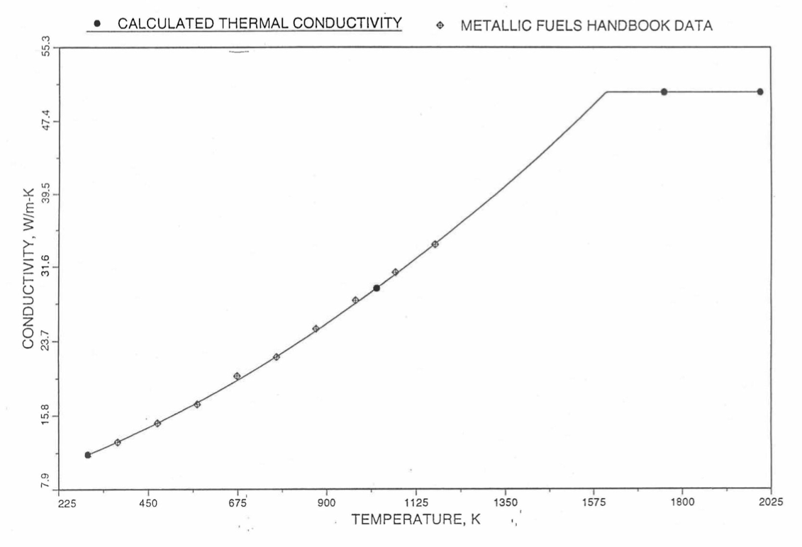

10.3.2.5.6. Subroutine KFUEL1 and Its Comparison With the Handbook Data
Figure 10.3.56 shows flow diagram of the subroutine KFUEL1 for calculating the thermal conductivity, based on this method of regionwise interpolation, of a 100% dense U-Pu-Zr fuel as a function of composition and temperature. This subroutine has been incorporated into the SAS4A/SASSYS-1 codes. For improving the computational speed, the coefficients of the quadratic for thermal conductivity of 100% dense U-Pu-Zr alloy of each input fuel type is pre-calculated before steady-state calculation, and used later in the steady-state and transient calculations of the codes.

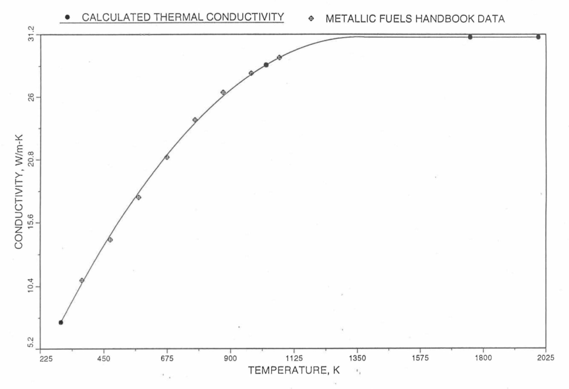

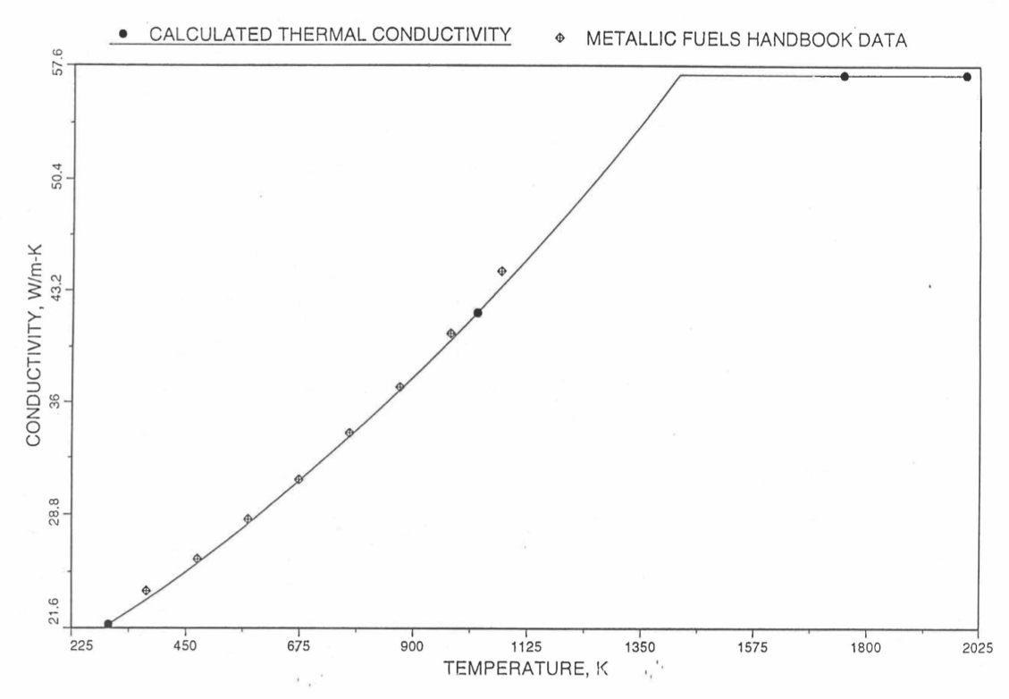

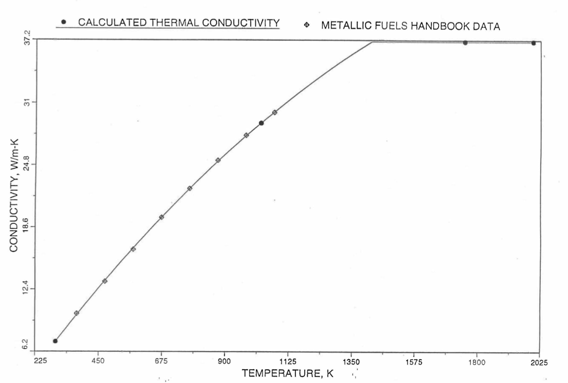

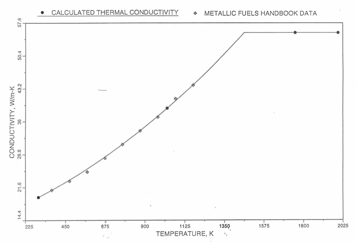

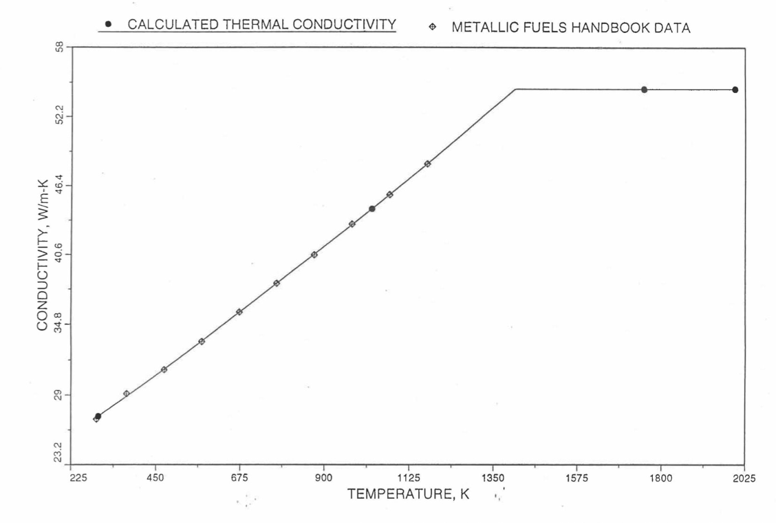

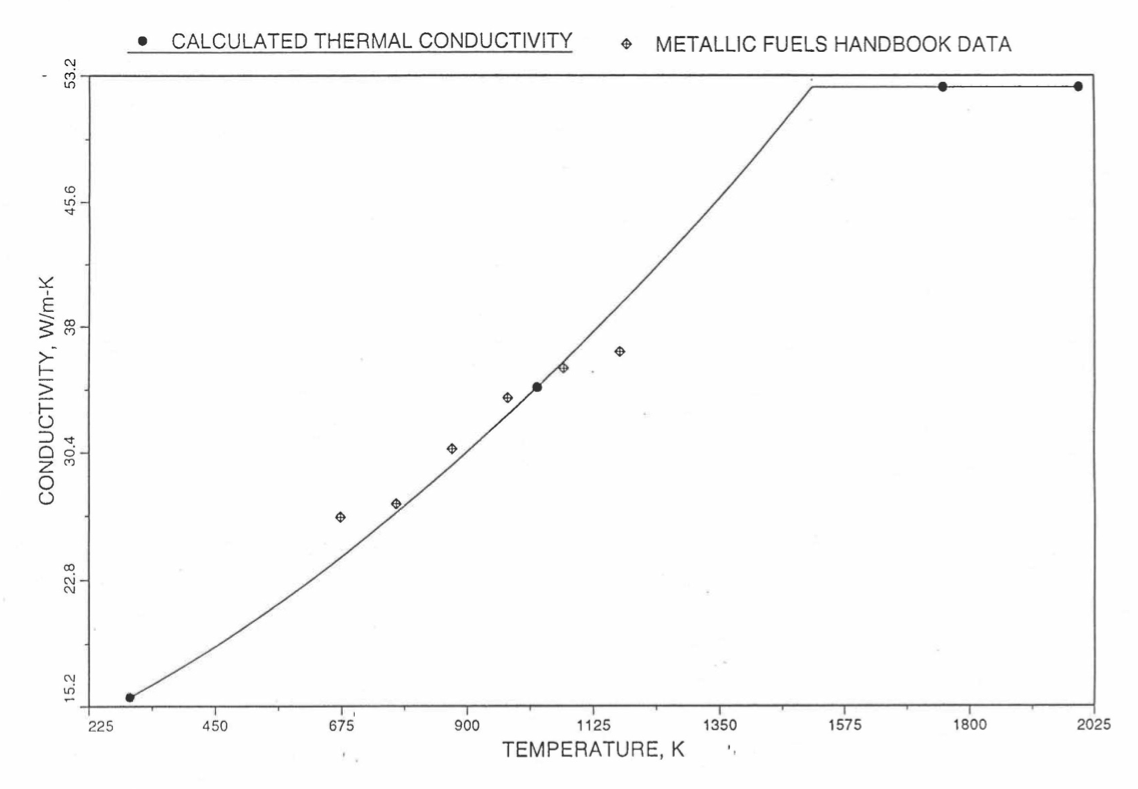

Figure 10.3.57 to Figure 10.3.67 show the comparison of calculated thermal conductivity with all the data in the Metallic Fuels Handbook [10-8] and with the data for U-10Pu alloy [10-21] and Pu metal [10-23] given in Table 10.3.4. There is a close agreement between the calculated and the measured thermal conductivities of all these alloys except U-11.4 Zr and Pu metal. In the case of u-11.4 Zr, there are two outlying data points, one at 673 K and the other at 1173 K, and the rest of the data points are in fair agreement with the calculated curve (Figure 10.3.60). It should be noted that the calculated curve for this alloy basically arises from the Handbook binary correlation [10-8], which is accurate for both the neighboring binary alloys (i.e., U-5Zr and U20Zr plotted in Figure 10.3.59 and Figure 10.3.61) for which data are available. Based on the degree of confidence in the Handbook binary correlation, the two outlying data points at 673 K and 1173 K are not believed to be reliable enough to require a revision of the subroutine KFUEL1. In the case of Pu metal, the scatter of the data points about the calculated curve is caused by a number of solid-state phase transitions. However, the behavior of Pu when alloyed with U and Zr is different from its behavior in isolation, and the smooth quadratic function of temperature use in calculation (in the subroutine KFUEL1) is closer to the expected behavior when alloyed.

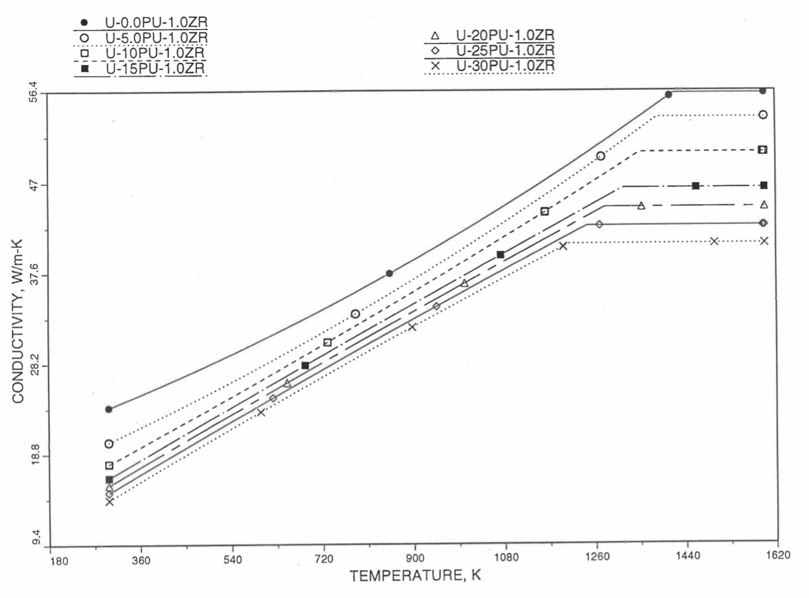

Figure 10.3.68 to Figure 10.3.70 show the variation of thermal conductivity with temperature for 20 100%-dense alloy compositions obtained from this subroutine. The Pu content varies from zero to 30 wt. % and the Zr content varies from 1.0 to 30 wt. % in the alloy compositions plotted in the figures. The solidus and liquidus temperatures required as input to the KFUEL1 subroutine were calculated using another subroutine developed by Pelton [10-13]. It should be noted that each thermal conductivity curve is flat at temperatures above the solidus temperature of the alloy. The thermal conductivities do not show any unphysical or unexpected behavior.
../../_images/image58.png
Figure 10.3.56 Flow Diagram of Subroutine KFUEL1 for 100% Dense U-Pu-Zr Thermal Conductivity.
../../_images/image59.png

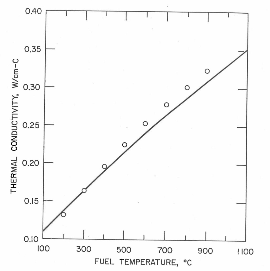

Figure 10.3.57 Comparison of 100% Dense Uranium Metal Thermal Conductivity Data in IFR Handbook With Those Calculated by Subroutine KFUEL1.

Figure 10.3.68 Thermal Conductivity of 100% Dense U-Pu-1.0Zr Alloy Fuel, Obtained From Regionwise Interpolation of IFR Handbook Data.

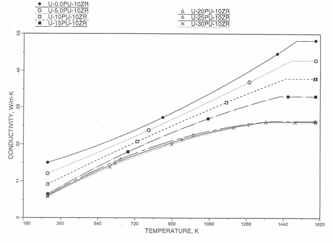

Figure 10.3.69 Thermal Conductivity of 100% Dense U-Pu-10Zr Alloy Fuel, Obtained From Regionwise Interpolation of IFR Handbook Data.

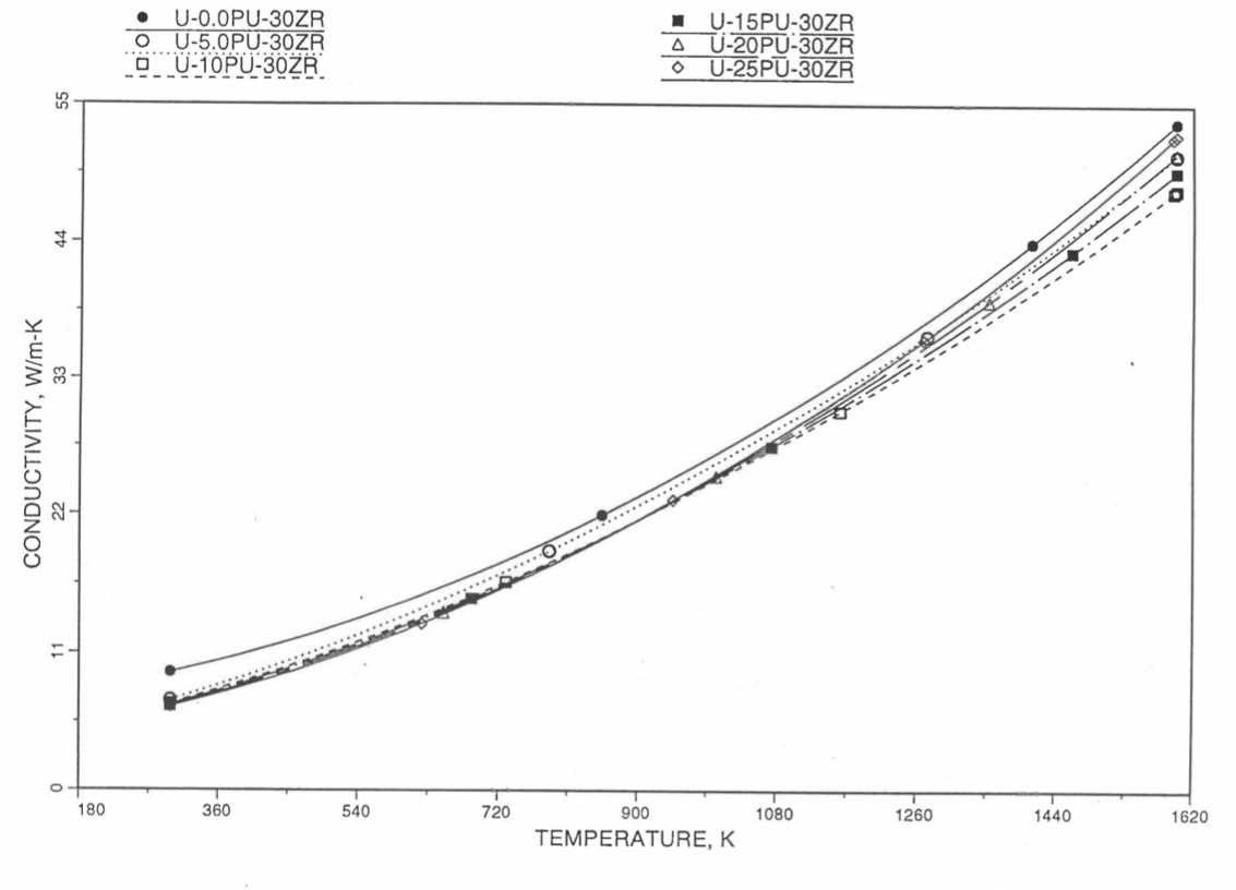

Figure 10.3.70 Thermal Conductivity of 100% Dense U-Pu-30Zr Alloy Fuel, Obtained From Regionwise Interpolation IFR Handbook Data.

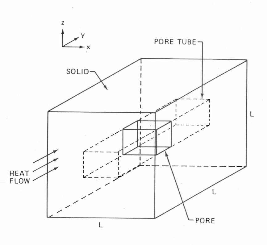

The fuel develops fission gas-filled porosities during steady-state operation of the reactor. The bond sodium used in the fuel-cladding gap of U-Pu-Zr alloy fuel pins can also migrate into the fuel and fill some of the porosities of the fuel after porosity interlinkage. The gas-filled porosities tend to decrease the fuel thermal conductivity whereas the sodium-filled porosities tend to increase it. The empirical correction based on average fuel burnup is suitable for transient calculations in which fuel porosity and sodium logging fraction do not change during the transient. If the distributions of fuel porosity and sodium logging fraction change during the transient, a method of correcting fuel thermal conductivity for irradiation effects that explicitly accounts for sodium- and gas-filled porosities is required. In this section a formula is derived for the evaluation of these two effects using a generalization of the method given in Ref. [10-26] for single type of porosity.
Assuming all the gas-filled pores to be cubes of the same size (side \(a_{1}\)) and all the sodium-filled pores to be cubes of another size (side \(a_{2}\)), a unit cell of the porous metallic fuel is constructed that contains a single gas-filled pore and a single sodium-filled pore as shown in Figure 10.3.71. The unit cell is a cube of side L and contains fully dense fuel surrounding the pores. In a real material the pores are not uniformly arranged like atoms in a crystal lattice; so the amount of solid fuel in the unit cell represents an average value. Assuming the heat flow in the y-direction only, the total heat flow through the front x-z face of the unit cell passes through three heat flow paths in parallel: (1) the pore tube containing the gas-filled pore (see Figure 10.3.71), (2) the pore tube containing the sodium-filled pore, and (3) the remaining frontal are of the fully dense fuel of thermal conductivity \(K_{\text{s}}\). The effective thermal conductivity of the unit cell in the y-direction is given by
(10.3-72)\[ K = P_{\text{c}1} K_{\text{pt}1} + P_{\text{c}2} K_{\text{pt}2} + \left( 1 - P_{\text{c}1} - P_{\text{c}2} \right) K_{\text{s}}\]
where
../../_images/image731.png
Figure 10.3.71 A Unit Cell of Porous Metallic Fuel Containing a Sodium-Filled Pore and a Gas-Filled Pore (Only One Pore is Shown for Clarity).
\(K\) = effective thermal conductivity of the fuel containing sodium-and gas-filled porosities.
\(P_{\text{c}1}, P_{\text{c}2}\) = fractions of the area of the x-z face of the unit cell that are occupied respectively by the gas-filled pore and the sodium-filled pore,
\(K_{\text{pt}1}, K_{\text{pt}2}\) = apparent thermal conductivities of the pore tubes containing the gas-filled pore and the sodium-filled pore.
The apparent thermal conductivity of a pore tube can be evaluated from the formula for two thermal resistances in series in the y-direction: (1) the pore proper, and (2) the solid fuel contained in the pore tube. For the two pore tubes one obtains the following equations:
(10.3-73)\[ \frac{1}{K_{\text{pt}1}} = \frac{P_{\text{L}1}}{K_{\text{g}}} + \frac{1 - P_{\text{L}1}}{K_{\text{s}}}\]
(10.3-74)\[ \frac{1}{K_{\text{pt}2}} = \frac{P_{\text{L}2}}{K_{\text{Na}}} + \frac{1 - P_{\text{L}2}}{K_{\text{s}}}\]
where
\(P_{\text{L}1}, P_{\text{L}2}\) = fractions of the side of the unit cell in the y-direction that are occupied respectively by the gas-filled pore and the sodium-filled pore,
\(K_{\text{g}}\) = thermal conductivity of the fission gas contained in the gas-filled pore,
\(K_{\text{Na}}\) = thermal conductivity of the sodium contained in the sodium-filled pore.
Neglecting \(K_{\text{g}}\) in comparison to \(K_{\text{s}}\) and \(K_{\text{Na}}\), and solving Eq. (10.3-73) for \(K_{\text{pt}1}\), it is found that \(K_{\text{pt}1}\) is zero. Substituting this value of \(K_{\text{pt}1}\) and the value of \(K_{\text{pt}2}\) obtained from Eq. (10.3-74) into Eq. (10.3-72), the effective thermal conductivity of the pours fuel can be written
(10.3-75)\[ \frac{K}{K_{\text{s}}} = \frac{P_{\text{c}2}K_{\text{Na}}}{K_{\text{s}}P_{\text{L}2} + \left( 1 - P_{\text{L}2} \right) K_{\text{Na}}} + 1 - P_{\text{c}1} - P_{\text{c}2}\]
The gas-filled volume porosity, \(P_{\text{g}}\), and the sodium-filled volume porosity, \(P_{\text{Na}}\), can be written as
(10.3-76)\[ P_{\text{g}} = \frac{P_{\text{c}1}}{P_{\text{L}1}}\]
(10.3-77)\[ P_{\text{Na}} = \frac{P_{\text{c}2}}{P_{\text{L}2}}\]
For the cubic gas-filled pore of side \(a_{1}\) shown in Fig. (Figure 10.3.71),
(10.3-78)\[ P_{\text{c}1} = \frac{a_{1}^{2}}{L^{2}}\]
(10.3-79)\[ P_{\text{L}1} = \frac{a_{1}}{\text{L}}\]
Eq. (10.3-76), Eq. (10.3-78) and Eq. (10.3-79) give the following relations of \(P_{\text{c}1}\) and \(P_{\text{L}1}\) to the gas-filled volume porosity \(P_{\text{g}}\).
(10.3-80)\[ P_{\text{c}1} = P_{\text{g}}^{2/3}\]
(10.3-81)\[ P_{\text{L}1} = P_{\text{g}}^{1/3}\]
Similarly, \(P_{\text{c}2}\) and \(P_{\text{L}2}\) can be related to the sodium-filled volume porosity, \(P_{\text{Na}}\), as follows:
(10.3-82)\[ P_{\text{c}2} = P_{\text{Na}}^{2/3}\]
(10.3-83)\[ P_{\text{L}2} = P_{\text{Na}}^{1/3}\]
Substituting Eq. (10.3-80), Eq. (10.3-82) and Eq. (10.3-83) into Eq. (10.3-75), the effective thermal conductivity of the porous fuel can be written as
(10.3-84)\[ \frac{K}{K_{\text{s}}} = 1 - P_{\text{g}}^{2/3} + \frac{P_{\text{Na}}^{2/3}}{\left( \frac{K_{\text{s}}}{K_{\text{Na}}} \right) P_{\text{Na}}^{1/3} + \left( 1 - P_{\text{Na}}^{1/3} \right)} - P_{\text{Na}}^{2/3}\]
Eq. (10.3-84) gives the effect of sodium- and gas-filled porosities on fully dense fuel thermal conductivity. It is noted that Eq. (10.3-84) satisfies two limiting conditions: (1) in the absence of any logged sodium in the fuel, the ratio \(K/K_{\text{s}}\) equals the known reduction factor of \(1 - P_{\text{g}}^{2/3}\) [10-26], and (2) if \(K_{\text{Na}}\) is set equal to \(K_{\text{s}}\) in Eq. (10.3-84), the last two terms on the right-hand side cancel to make \(K/K_{\text{s}}\) again equal to \(1 - P_{\text{g}}^{2/3}\) which is expected when the sodium and the fully dense fuel behave alike and gas-filled porosity is the only nonconductive porosity in the material.

10.3.3.2. Thermal Expansion of U-Pu-Zr Fuel
The U-Pu-Zr alloys show strong discontinuities in the coefficient of linear thermal expansion when the alloys are heated through the phase transformation temperatures [10-15]. There is some variation between the coefficients of linear expansion of alloys of different compositions but there is not enough data available to correlate this variation as a function of composition. This fuel properties option assumes the coefficient of linear expansion to be independent of composition, and uses the thermal expansion of U-15 wt % Pu-10 wt % Zr for all alloy compositions. The measured values of U-15 wt % Pu-10 wt % Zr alloy linear thermal expansion have been correlated as follows:
(10.3-93)\[\begin{split} \frac{\Delta L \left( T \right)}{L_{1}} = \begin{cases} 1.76 \times 10^{-5} \left( T - 298 \right) , & T \leq 873\text{ K} \\ 1.012 \times 10^{-2} + 1.05 \times 10^{-4} \left( T - 873 \right), & 873 < T \leq 923\text{ K} \\ 1.537 \times 10^{-2} + 2.04 \times 10^{-5} \left( T - 923 \right), & T > 923\text{ K} \\ \end{cases}\end{split}\]
where
\(\frac{\Delta L \left( T \right)}{L_{1}}\) = linear thermal expansion from a fixed temperature 298K to any temperature T, expressed as a fraction of length \(L_{1}\) at the temperature 298K.
Using Eq. (10.3-92) and Eq. (10.3-93), the following equation for the theoretical density of U-Pu-Zr alloy fuel at any temperature T in units of kg/m3 is obtained:
(10.3-94)\[ \rho_{\text{th}} \left( T, W_{\text{p}}, W_{\text{z}} \right) = \frac{1000}{\left( \frac{238.07 W_{\text{u}}}{19.04 a_{\text{u}}} + \frac{239.13 W_{\text{p}}}{19.805 a_{\text{p}}} + \frac{W_{\text{z}}}{6.51} \right)} \frac{1}{\left\lbrack 1 + \frac{\Delta L\left( T \right)}{L_{1}} \right\rbrack^{3}}\]

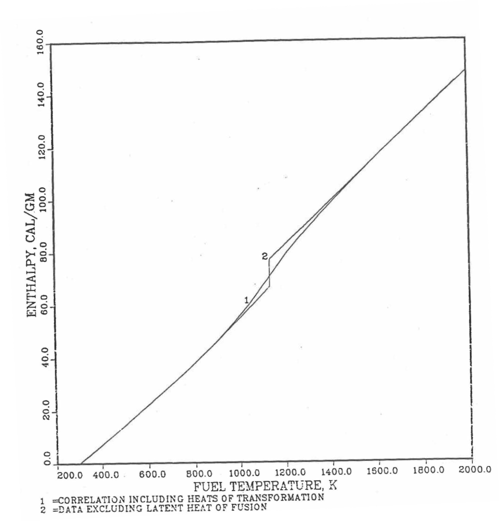

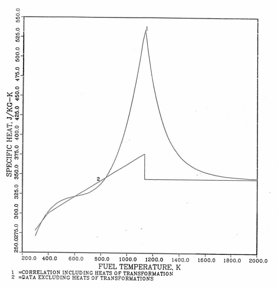

10.3.3.3. Enthalpy and Specific Heat of U-Pu-Zr Fuel
The composition-dependent enthalpy and specific heat of U-Pu-Zr alloy at any temperature up to is solidus temperature are estimated by mass-weighted averaging of the enthalpy and specific heat data of U, Pu and Zr metals, assuming that the heat of formation of the alloy is negligible. The heat of formation of the alloy is assumed negligible due to lack of data.
Each of the constituent metals of the U-Pu-Zr alloy undergoes certain crystallographic phase transformations in the solid state which require considerable heat addition and enthalpy increase at the transformation temperatures. The specific heat data of U, Pu, and Zr excluding these heats of solid-state transformations [10-10] are given in Tables 10.3-9 to 10.3-11, and plotted in Figure 10.3.72 to Figure 10.3.74. In each plot, the value of specific heat between the highest solid-state transformation temperature and the melting point is shown extrapolated to a temperature of 2000K for curve-fitting purposes, although the fitted equations are used only up to a solidus temperature of the U-Pu-Zr alloy. Because the heat transfer routines of the SAS4A/SASSYS-1 codes were initially written for the mixed-oxide fuel without any heat of solid-heat transformation, the heats of solid-state transformations of U, Pu and Zr are required to be included in their specific heats by spreading the corresponding enthalpy jumps over a temperature range. This spreading is not all artificial because these solid-state transformations actually occur over a temperature range in the U-Pu-Zr alloy. Hence the equations fitted to the specific heat and enthalpy data of U, Pu and Zr metals are required (1) to be continuous (no sudden jumps at any temperature) for the purpose of accuracy and convergence of the numerical solution in the SAS4A/SASSYS-1 heat transfer routines, (2) to include the heats of solid-state transformations such that the fitted equations cross the enthalpy jumps close to their midpoints, and (3) to closely reproduce the enthalpy and specific heat data away from the solid-state transformations. When one polynomial could not be fitted over the whole temperature range, the data for each metal was fitted in two parts: a polynomial over the lower temperature range covering most of the solid-state transformations, and an equation of the form a+b/Tn over the higher temperature range. The following equations for the specific heats (in units of J/kg-K) of U, Pu and Zr metals and the U-Pu-Zr alloy are obtained.
(10.3-95)\[\begin{split} C_{\text{pu}}\left( T \right) = \begin{cases} 0.72516 T - 1.4232 \times 10^{-3} T^{2} + 1.0134 \times 10^{-6} T^{3}~, & T \leq 1000\text{ K} \\ 160.9 + 154.5 \left( \frac{1000}{T} \right)^{8}~, & T > 1000 \text{ K} \\ \end{cases}\end{split}\]
(10.3-96)\[\begin{split} C_{\text{pp}}\left( T \right) = \begin{cases} - 1202.3 + 9.0307 T - 0.018232 T^{2} + 1.1616 \times 10^{-5} T^{3}~, & T \leq 753\text{ K} \\ 147.0 + 72.65 \left( \frac{753}{T} \right)^{9}~, & T > 753\text{ K} \\ \end{cases}\end{split}\]
(10.3-97)\[\begin{split} C_{\text{pz}}\left( T \right) = \begin{cases} - 7.0215 + 1.5493 T - 2.4845 \times 10^{-3} T^{2} + 1.3587 \times 10^{-6} T^{3}~, & T \leq 1136\text{ K} \\ 344.2 + 196.4 \left( \frac{1136}{T} \right)^{9}~, & T > 1136\text{ K} \\ \end{cases}\end{split}\]
(10.3-98)\[ C_{\text{p}} \left( T, W_{\text{p}}, W_{\text{z}} \right) = W_{\text{u}} C_{\text{pu}} \left( T \right) + W_{\text{p}} C_{\text{pp}} \left( T \right) + W_{\text{z}} C_{\text{pz}} \left( T \right)\]
where
\(C_{\text{pu}} \left( T \right), C_{\text{pp}} \left( T \right), C_{\text{pz}} \left( T \right)\) = specific heats of U,Pu and Zr metals at temperature T, J/kg-K,
\(C_{\text{p}} \left( T, W_{\text{p}}, W_{\text{z}} \right)\) = composition-dependent specific heat of the U-Pu-Zr alloy, J/kg-K,
\(W_{\text{u}}, W_{\text{p}}, W_{\text{z}}\) = weight fractions of U,Pu and Zr in the U-Pu-Zr alloy.
Eq. (10.3-95) to Eq. (10.3-97) for the specific heats of U, Pu and Zr metals are compared with the data of Tables 10.3-9 to 10.3-11 in Figure 10.3.72 to Figure 10.3.74. The lower and the higher temperature-range-fitted equations join without any discontinuity at the range interface temperature. The enthalpies obtained by integrating Eq. (10.3-95) to Eq. (10.3-97) are compared with the measured data of Tables 10.3-9 to 10.3-11 in Figure 10.3.75 to Figure 10.3.77. The enthalpy obtained from the higher temperature-range-fitted equation merges asymptotically with the data. A comparison of the enthalpy obtained from Eq. (10.3-98) for alloys of several compositions (e.g., those formed in the annular zones) is required to test the validity of this technique.

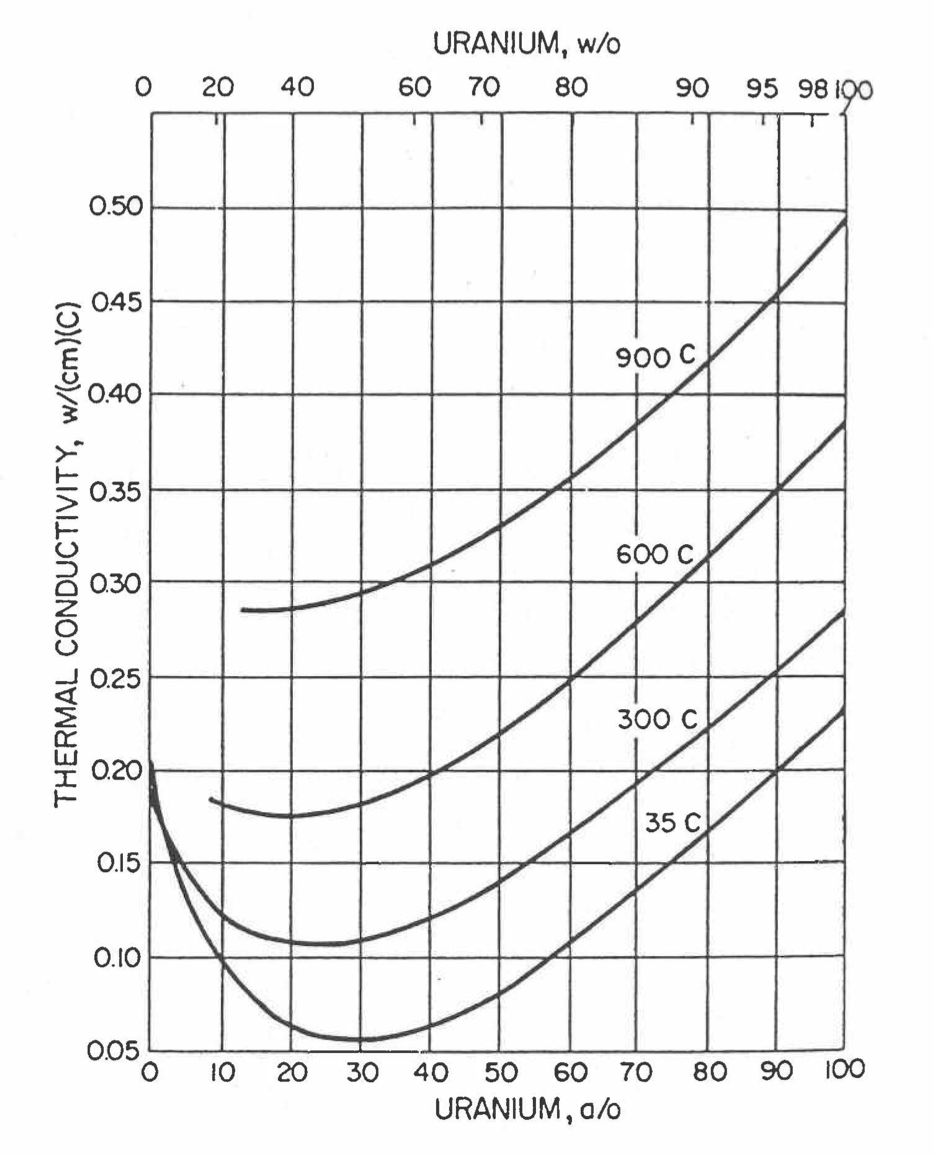

Figure 10.3.78 shows that the thermal conductivity of U-Zr binary alloy decreased linearly with Zr atom fraction in the range of zero to 0.5. Therefore, quadratic functions are least-square fitted to the pure uranium thermal conductivity data and to the U-50 atom % zr binary alloy data of Figure 10.3.78, and then the thermal conductivity of any U-Zr binary alloy in the composition range of zero to 50 at. % Zr is linearly interpolated between these two quadratics. The resulting equations are as follows:
(10.3-99)\[ K_{\text{u}} = 0.22173 + 1.8562 \times 10^{-4} T_{\text{c}} + 1.3278 \times 10^{-7} T_{\text{c}}^{2}\]
(10.3-100)\[ K_{\text{u}50} = 0.074766 + 1.6738 \times 10^{-4} T_{\text{c}} + 1.1599 \times 10^{-7} T_{\text{c}}^{2}\]
(10.3-101)\[ K_{\text{uz}} = K_{\text{u}} + \frac{2A_{\text{z}}}{A_{\text{u}} + A_{\text{z}}} \left( K_{\text{u}50} - K_{\text{u}} \right)\]

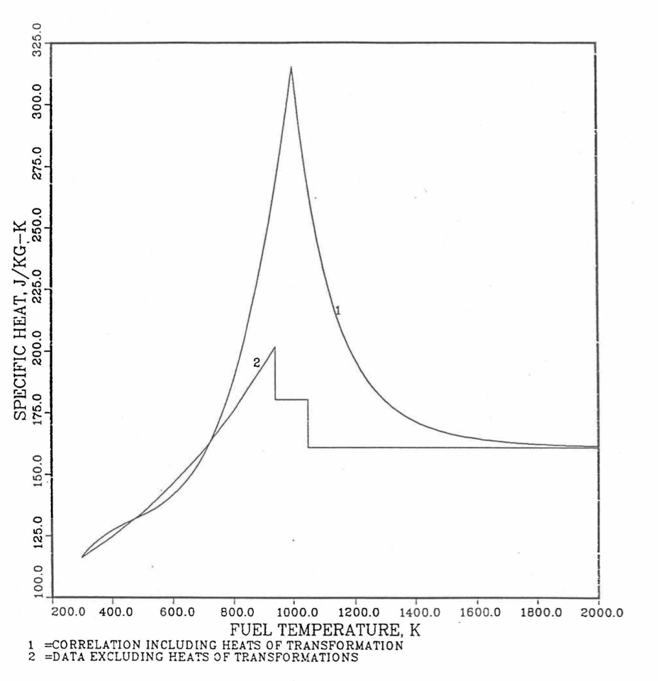

../../_images/image74.png
Figure 10.3.72 Uranium Specific Heat Correlation Including the Heats of SolidState Transformations.

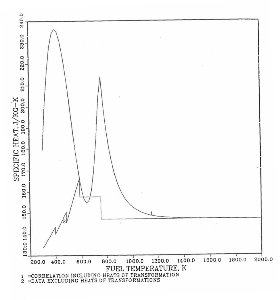

Figure 10.3.73 Plutonium Specific Heat Correlation Including the Heats of SolidState Temperature.
../../_images/image76.png
Figure 10.3.74 Zirconium Specific Heat Correlation Including the Heats of SolidState Transformations.

Eq. (10.3-99) and Eq. (10.3-100) reproduce the thermal conductivity data shown in Figure 10.3.78 for pure uranium and U-50 atom % Zr binary alloy with a maximum error of 1.5%. Eq. (10.3-101) for the thermal conductivity of U-Zr binary alloys has been compared in Table 10.3.13 with the data [10-18] for U-20 wt. % Zr (U-39.5 atom & Zr) binary alloy and the maximum error is about 5%. Eq. (10.3-101) is so written that it determines the thermal conductivity of the U-Zr binary alloy to which Pu can be added to obtain the desired U-Pu-Zr ternary alloy with U, Pu and Zr atom fractions equal to \(A_{\text{u}}, A_{\text{p}}\) and \(A_{\text{z}}\). The addition of Pu to the U-Zr binary alloy decreases the thermal conductivity. Because of a lack of the ternary alloy thermal conductivity data at widely spaced Pu atom fractions, only a linear dependence on Pu atom fraction is assumed in this evaluation.

../../_images/image77.png
Figure 10.3.75 Uranium Enthalpy Obtained by Integrating its Specific Heat Correlation.
../../_images/image78.png
Figure 10.3.76 Plutonium Enthalpy Obtained by Integrating its Specific Heat Correlation.
../../_images/image79.png
Figure 10.3.77 Zirconium Enthalpy Obtained by Integrating its Specific Heat Correlation.
../../_images/image80.png
Figure 10.3.78 Thermal Conductivity of the Uranium-Zirconium Binary Alloy for the Full Range of Composition.

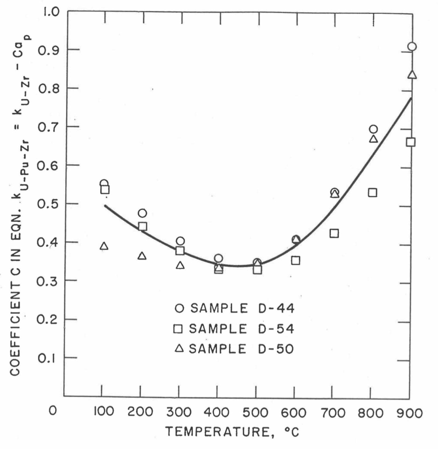

Table 10.3.14 Temperature Variation of the Plutonium Alloying Coefficient \(C\) Evaluated from the Thermal Conductivity Data for Three U-Pu-Zr Alloys Prepared in Casting Numbers D-44, D-54 and D-50
Thermal Conductivity, W/cm-°C
Temperature, °C
U-Pu-Zr Casting
U-Zr Binary With U to Zr Atom Ratio Same as Casting
Coefficient C
Casting Number D-44, U-14.7 at.% Pu-14.7 at.% Zr Alloy
100
0.109
0.190
0.554
200
0.142
0.212
0.477
300
0.177
0.236
0.404
400
0.210
0.263
0.362
500
0.241
0.292
0.351
600
0.264
0.324
0.412
700
0.280
0.359
0.537
800
0.293
0.396
0.701
900
0.301
0.435
0.916
Casting Number D-54, U-12.7 at.% Pu-21.9 at.% Zr Alloy
100
0.100
0.167
0.529
200
0.132
0.188
0.445
300
0.164
0.212
0.381
400
0.196
0.238
0.336
500
0.225
0.267
0.335
600
0.253
0.299
0.361
700
0.278
0.332
0.431
800
0.301
0.369
0.536
900
0.323
0.408
0.668
Casting Number D-50, U-15.5 at.% Pu-25.3 at.% Zr Alloy
100
0.092
0.152
0.390
200
0.117
0.173
0.365
300
0.144
0.197
0.344
400
0.171
0.223
0.337
500
0.197
0.252
0.354
600
0.219
0.283
0.412
700
0.234
0.316
0.531
800
0.248
0.352
0.673
900
0.260
0.390
0.843

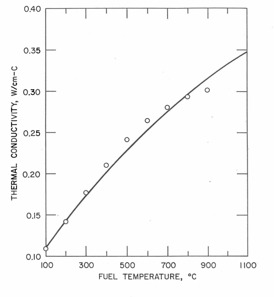

../../_images/image811.png
Figure 10.3.79 Plot of Coefficient C vs. Temperature Obtained from Thermal Conductivity Data for U-Pu-Zr Samples D-44, D-54 and D-50.
The coefficient \(C\) has been evaluated (see table 10.3-14) from the thermal conductivity data given in Table 10.3.12 for three U-Pu-Zr alloys prepared in casting numbers D-44, D-54 and D-50 [10-19, 10-20], and Figure 10.3.79 shows a plot of these values of the coefficient \(C\) versus temperature. The scatter in Figure 10.3.79 indicates that the coefficient \(C\) may have a weak dependence on Zr atom fraction in addition to the main dependence on temperature. The following two equations have been developed for evaluating the coefficient \(C\): (1) a second degree polynomial of temperature only (ignoring the weak dependence on Zr atom fraction) least-squared fitted to the data given in Table 10.3.12 up to 900°C using \(A_{\text{p}}^{2}\) as the weighting factor, and (2) a second degree polynomial of temperature with its coefficients linearly depending on Zr atom fraction least-square fitted to all the data given in Table 10.3.12 up to 2000°C using \(\left\lbrack K_{\text{o}} \left( T_{\text{c}}, A_{\text{p}}, A_{\text{z}} \right) \right\rbrack^{-2}\) as the weighting factor. The \(A_{\text{p}}^{2}\) weighting factor was used to reduce the errors in the first fitting equation at higher Pu atom fractions and make them nearly equal to the errors at lower Pu atom fractions. The \(1/K_{\text{p}}^{2}\) weighting factor was used in the second case for the purpose of minimizing the mean fractional error in thermal conductivity. The fitted equations are given below with their expected ranges of validity.
(10.3-103)\[\begin{split}C = 0.63477 - 1.4980 \times 10^{-3} T_{\text{c}} + 1.8878 \times 10^{-6} T_{\text{c}}^{2},\\ 100 \leq T_{\text{c}} \leq 1200,\ \ 0.0 \leq A_{\text{p}} \leq 0.16,\ \ 0.0 \leq A_{\text{z}} \leq 0.50\end{split}\]
(10.3-104)\[\begin{split}C = \left( 0.89079 - 1.6757 A_{\text{z}} \right) - T_{\text{c}} \left( 1.7437 \times 10^{-3} - 4.0008 \times 10^{-3} A_{\text{z}} \right) + \\ T_{\text{c}}^{2} \left( 1.9608 \times 10^{-6} - 3.1043 \times 10^{-6} A_{\text{z}} \right), \\ 100 \leq T_{\text{c}} \leq 1500, \ \ 0.0 \leq A_{\text{p}} \leq 0.20, \ \ 0.0 \leq A_{\text{z}} \leq 0.50\end{split}\]

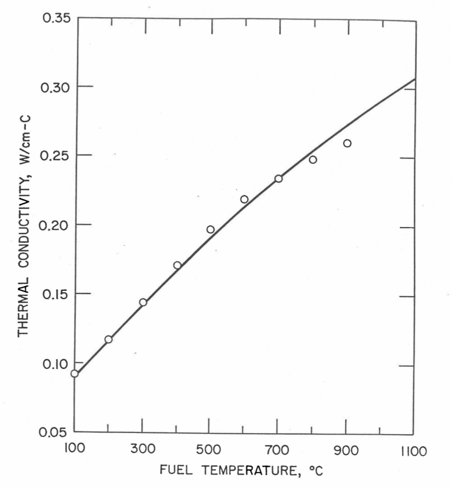

Figure 10.3.80 to Figure 10.3.82 compare the U-Pu-Zr alloy thermal conductivity obtained from Eq. (10.3-102) and Eq. (10.3-104) with the data for the three U-Pu-Zr alloys prepared in casting numbers D-44, D-54 and D-50 [10-19, 19-20]. The correlation compares well with all the base data with a root mean square error of 5% and a maximum error of about 10%. Eq. (10.3-104) for evaluating the coefficient \(C\) covers a wider range of composition and temperature than Eq. (10.3-103) and is preferred. Further comparison for alloys of other compositions (i.e., those formed in the annular zones) and at temperatures higher than 900°C is required to test the validity of the assumptions used in this correlation.
The IFR Handbook correlation given by Eq. (10.7-12) reproduces all the base data of Table 10.3.12 over the temperature range 100-900°C with a maximum error of about 20% compared to the maximum error of about 10% in the correlation Eq. (10.3-102) and Eq. (10.3-104).
../../_images/image821.png
Figure 10.3.80 Comparison of the Thermal Conductivity Correlation Eq. (10.3-102) and Eq. (10.3-104) with the Data for the U-Pu-Zr Sample D-44.
../../_images/image831.png
Figure 10.3.81 Comparison of the Thermal Conductivity Correlation Eq. (10.3-102) and Eq. (10.3-104) with the Data for the U-Pu-Zr Sample D-54.
../../_images/image84.png
Figure 10.3.82 Comparison of the Thermal Conductivity Correlation Eq. (10.3-102) and Eq. (10.3-104) with the Data for the U-Pu-Zr Sample D-50.

10.3.5. Computer Implementation
The U-Pu-Zr alloy composition in each computational cell of the fuel is at present specified both axially and radially by input data determined from the examination fuel pins with similar irradiation histories. Input data are handled by annular fuel zones (central, middle and outer composition zones) but the codes internally have arrays by radial node to store U-Pu-Zr fuel composition and composition-dependent quantities. The choice of input data by fuel zone is based on the fact that analysts communicate commonly in terms of zones, and that this simplifies input data preparation. The use of storage by radial node is based on the fact that this reduces logical IF statements from coding, especially in molten material motion models. This should simplify the codes and improve the running time. The addition of composition-dependent fuel thermal properties in the input data is an option in the codes, and the user should be able to run no-zone formation cases without preparing the input data for multiple fuel zones. This section describes the functions of all the fuel thermal property subroutines, the related input data, and internal arrays.
10.3.5.1. List of Fuel Thermal Property Subroutines
The following is a list of all the fuel thermal property subroutines with a brief description of their functions:
Name
Descriptions
CFUEL
Computes specific heat of mixed-oxide, U-Fs and U-Pu-Zr alloy fuels for a range of fuel radial nodes in an axial segment, with specified temperatures and U-Pu-Zr compositions.
CFUEL1
Computes U-Pu-Zr alloy fuel specific heat as a function of composition and temperature by regionswise interpolation of Metallic Fuels Handbook enthalpy data.
FK
Computes thermal conductivity of mixed-oxide, U-Fs and U-Pu-Zr alloy fuels for a single fuel radial node in an axial segment, with specified temperature, porosity and U-Pu-Zr composition. In the case of metal fuels, it also accounts for the effect of sodium logging.
HFUEL1
Computes U-Pu-Zr alloy fuel enthalpy as a function of composition and temperature by regionwise interpolation of Metallic Fuels Handbook enthalpy data.
KFUEL
Computes thermal conductivity of mixed oxide, U-Fs and U-Pu-Zr alloy fuels for a range of fuel radial nodes in an axial segment, with specified temperatures, porosity and U-Pu-Zr compositions. In the case of metal fuels, it also accounts for the effect of sodium logging.
KFUEL1
Computes thermal conductivity of unirradiated 100%-dense U-Pu-Zr alloy fuel as a function of composition and temperature, by the method of regionwise interpolation of Metallic Fuels Handbook thermal conductivity data.
PELTON
Computes solidus and liquidus temperatures of U-Pu-Zr alloy fuel as a function of composition, by the method of chemical thermodynamic equilibrium between conjugate solid and liquid solutions.
PRECAL
Ppre-calculates, before steady-stat calculation, a number of parameters stored for fast evaluation of U-Pu-Zr specific heat, theoretical density and thermal conductivity by fuel type.
RHOF
Computes theoretical density of mixed-oxide, U-Fs and U-Pu-Zr alloy fuels for a specified temperature and U-Pu-Zr composition.
RHOFM
Computes theoretical density of U-Pu-Zr fuel as function of composition and temperature, and also returns the fractional linear thermal expansion over the input temperature range.
THEXP1
Computes fractional linear thermal expansion of U-Pu-Zr alloy fuel as a function of composition and temperature, by the method of regionwise interpolation of Metallic Fuels Handbook data.
TRTEMP
Evaluates the first and last solid-state transition temperatures of U-Pu-Zr alloy fuel as a function of composition.
