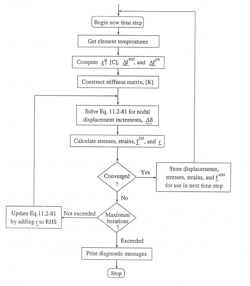

The equilibrium equations, Eq. (11.2-1), and the linear equations, Eq. (11.2-2), are solved iteratively for each axial segment by making use of residuals. In this scheme, first the stiffness matrix, \(\left\lbrack K \right\rbrack\), and an initial guess for the force vector, \(\underline{f}_{0}\), are assembled using available information from the previous time step. Then, the linear equations Eq. (11.2-2) are solved for the new nodal displacements, and from them the increments of total strain are obtained. Assuming that the total material strain is a superposition of elastic, plastic, thermal, and swelling strains, the elastic component of the increments of total strain is separated (see Section 11.2.2) and used to calculate the stress field throughout the fuel element that satisfies the material constitutive equations. These stresses, then, are used to obtain the residuals form the equilibrium equations, Eq. (11.2-1), as follows
(11.2-3)\[\underline{r}_{\text{n}} = \underline{f}^{\text{ext}} - \underline{f}^{\text{int}}\left( \sigma_{\text{n}} \right)\]
where \(n\) is the iteration index. Using these residuals, the initial estimate for the force vector in linear equations Eq. (11.2-2) is modified according to
(11.2-4)\[\underline{f}_{\text{n} + 1} = \underline{f}_{\text{n}} + \underline{r}_{\text{n}}\]
The procedure is repeated until convergence is established. This basic scheme is generalized in FPIN2 to include analysis of additional material performance in fuel and cladding such as cracking and melting.
The details of this procedure described above are given in the following sections. The basic stress, strain, and nodal displacement relationships are discussed in Section 11.2.1, and the algorithm for separating elastic strain from the total strain is presented in Section 11.2.2. FPIN2 uses a continuous cracking model that permits cracks in the radial plane. The principles of this model are described in Section 11.2.3. The finite element formulation and the details of the implicit solution scheme outlined above are presented in Section 11.2.4. The formulations given in the aforementioned sections are based on updated geometry and can handle large strains. This is accomplished by performing the mechanics calculation on an incremental basis and updating the fuel element geometry at the end of each time step as described in Section 11.2.5.

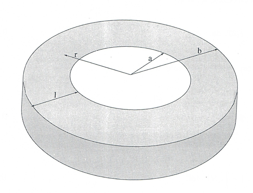

11.2.1. Basic Stress-Strain-Displacement Equations
In this section, a number of definitions and basic equations relating stresses, strains, and modal displacements are collected and presented in a uniform notation. These equations constitute the foundation of FPIN2’s mechanics model and serve as the basis for derivations in later sections. Formulas are derived for large-strain finite element analysis of deformation in a cylindrical fuel element under accident conditions. At the beginning of the analysis, the fuel element is assumed to be stress-free with steady-state thermal conditions. Thermoeleastic-plastic behavior is assumed for both the fuel and cladding. Swelling (including hot-pressing) and cracking are also allowed in both materials.

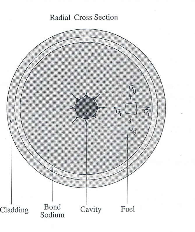

Fuel elements are assumed to consist of a number of axial segments. The finite elements are defined in each axial segment separately and allowed to interact only at the radial boundaries (nodes). The displacements within the elements are approximated by linear functions of the nodal displacements. Axial symmetry of temperatures and external loads is assumed; therefore, the finite elements can be viewed as a series of concentric annular rings. The generalized plane strain assumption is used describe the interaction between the axial segments.
../../_images/image315.png
Figure 11.2.1 FPIN2 Geometry
Each axial segment is allowed to have regions containing central cavity gas and/or molten fuel, regions of solid material that are uncracked, and regions that contain radial cracks (Figure 11.2.1). If an element does not contain any cracks, the axisymmetry assumption dictates that the deformation depends only on \(r\). Although the existence of radial cracks, in general, destroys this symmetry, it is assumed that the number of cracks in an element is large enough to make the deformation essentially axisymmetric.

A linear approximation is used for the finite-element displacement function, \(\phi_{\text{r}}\), appearing in the virtual work equations. For the one-dimensional element in Figure 11.2.2, it is given by
(11.2-62)\[\phi_{\text{r}} = u_{1} N_{1} + u_{2} N_{2}\]
where \(u_{1}\) and \(u_{2}\) are the radial displacements of nodes 1 and 2, and the shape functions are
(11.2-63)\[N_{1} = \frac{b - r}{l}\]
and
(11.2-64)\[N_{2} = \frac{r - a}{l}\]
Substituting Eq. (11.2-62) into the virtual work equation, Eq. (11.2-61), and integrating over the area of the element, \(A_{\text{e}}\), we get [6]
(11.2-65)\[{\int_{\text{A}_{\text{e}}}\left\lbrack B \right\rbrack}^{T} \text{dA} = \left\{ t_{1}, t_{2}, F \right\}^{T}\]
where \(\left\lbrack B \right\rbrack, t_{1}\) and \(t_{2}\) are defined as
(11.2-66)\[\begin{split}\left\lbrack B \right\rbrack = \frac{1}{1}\begin{bmatrix} - 1 & 1 & 0 \\ \left( \frac{b}{r} - 1 \right) & \left( 1 - \frac{a}{r} \right) & 0 \\ 0 & 0 & 1 \end{bmatrix}\end{split}\]
(11.2-67)\[\begin{aligned} t_{\text{i}} = \int_{\text{C}}{\sigma_{\text{r}} N_{\text{i}}}{\hat{i}}_{\text{r}} \cdot \hat{n}\text{dC} && \left( i=1,2 \right)~. \end{aligned}\]
../../_images/image410.png
Figure 11.2.2 Finite Element Cross Section

11.2.4.3. Iterative Solution of the Equilibrium Equations
Eq. (11.2-77) is the incremental form of the virtual work (or equilibrium) equation. Since the stiffness matrix \(\left\lbrack K \right\rbrack_{\text{i}}\) is known, it constitutes a set of linear equations that can be solved for the displacement increments, \(\underline{\Delta \delta}\). Eq. (11.2-75) then gives the increment in apparent total strain, \(\underline{\Delta \varepsilon}\), and the algorithm described in Section 11.2.2 gives the stresses at time \(t_{\text{i}+1}\). These stresses, in turn, can be used in Eq. (11.2-69) to calculate the internal force vector. However, since the expression for the stress increment in Eq. (11.2-72) is only approximate, the equilibrium equation Eq. (11.2-68) will not be satisfied in general.
In FPIN2, another iterative procedure is used to ensure that the stress estimates satisfy the equilibrium equation to an acceptable degree of accuracy. By defining the residual, or the error, in Eq. (11.2-68) as follows
(11.2-80)\[ \underline{r} = \underline{f}_{\text{i} + 1}^{\text{ext}} - \underline{f}_{\text{i} + 1}^{\text{int}}\]
The successive evaluations of the nodal variable increments, \(\underline{\Delta \delta}\), are calculated from
(11.2-81)\[ \left( K \right)_{\text{i}}\underline{\Delta \delta}_{\text{j}} = \underline{\Delta f}^{\text{ext}} + \underline{\Delta f}_{\text{i}}^{\text{ps}} + \underline{r}_{\text{j} - 1}\]
where \(j\) is the iteration index.
The convergence of this iterative scheme is monitored through the norm of the residual vector. If this error is sufficiently small, then the equilibrium equations are assumed to be satisfied and the computation is advanced to the next time step. Otherwise, the new residual vector \(\underline{r}_{\text{j}}\), is calculated and added to the right hand side of Eq. (11.2-81) (the previous residual vector, \(\underline{r}_{\text{i} + 1}\), remains there as well). Figure 11.2.3 summarizes this algorithm for iterative solution of the equilibrium equations.
../../_images/image510.png
Figure 11.2.3 Iterative Solution of Equilibrium Equations
